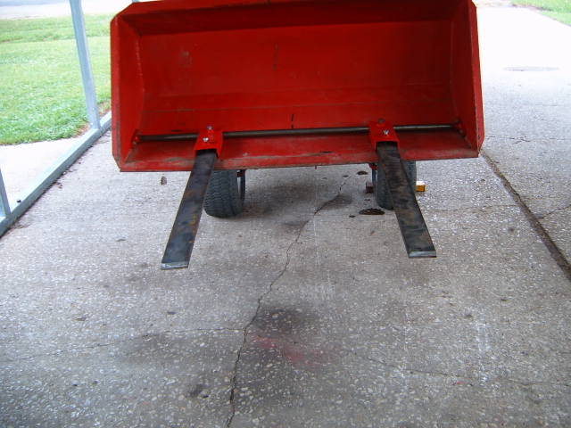

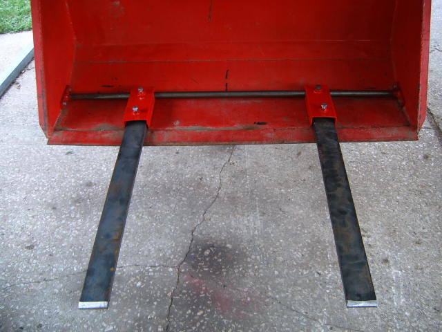

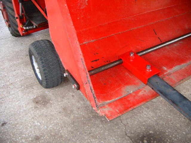

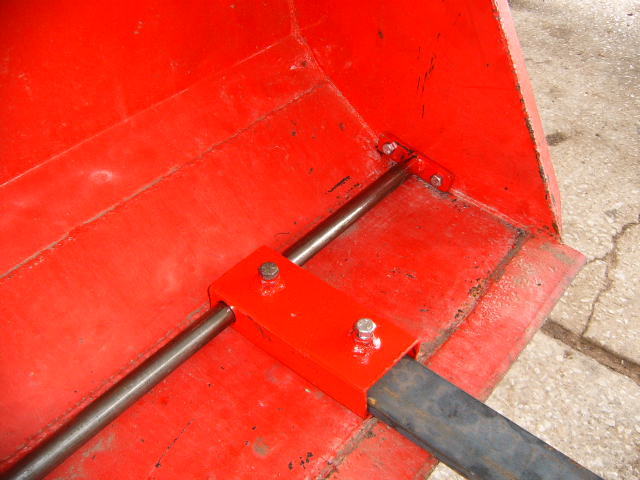

elliot ness 1,916 #1 Posted August 25, 2016 I built a set of forks for the loader tractor. made them simple and easy to adjust side to side and to remove all hardware with 4 bolts on the side of the bucket. will let you know how they work at a later date. The cross rod is 7/8 in. cold rolled steel, and the forks are 1/2 x3 in.. and the square tubing is 1 1/2 x 3 in. I put 2 locking bolts on the square stock to hold the forks in place You can move the forks in or out where ever you need them. 15 Share this post Link to post Share on other sites
