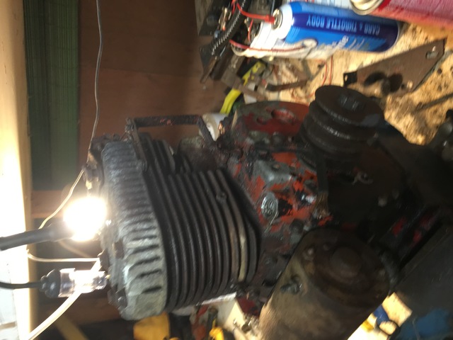

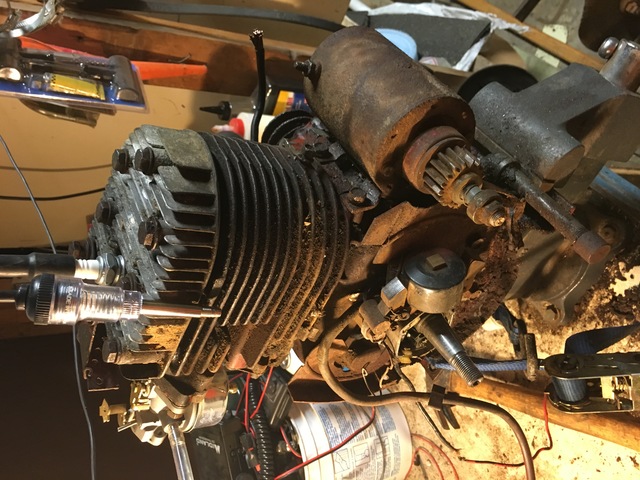

Help!! :greetings-clappingyellow: My horse is either a 656 or a 655. Trying to figure out if it's a Tecumseh H60 or the HH60 so I can order ignition parts! Sorry for the pics, still trying to learn the mobile site!
Howie
 if it is an aluminum block it is a H60, cast iron a HH60. Although I think the ignition parts are the same for both.
;hh
  • Like 1
Team70R
30547A  points?
And 30548B condenser?
Howie
Yes that is the most widely used points and condenser.
