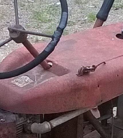

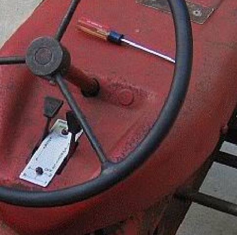

CasualObserver 3,416 #11 Posted August 19, 2016 The only real differences between the 400 and the 550 is unfortunately the engine and the electrical start components, and possibly the hood. The 550 had fenders and toolbox standard, the 400 may or may not have come with the option of fenders and toolbox so even that is not tell-tale. Examine the toolbox under the seat (if there is one) for any extra holes that would be from a solenoid mounting spot or evidence that there was a battery sitting in there. Also look just to the right of the steering column in the dash. Is the dash solid, is there a hole, or is there a plug? If it's solid, or there is a plug, your tractor was a 400, if there is a hole, the tractor might have been a 550. (also might not, because there could have been a plug and it was lost.) Early 400 (no hole or plug) Later 400 (with knock out plug in ignition hole) 4 Share this post Link to post Share on other sites

wallfish 20,053 #16 Posted August 20, 2016 To answer the original thread question, IMO @CasualObserver hit the nail directly on the head and provided all the correct information to it. 3 Share this post Link to post Share on other sites
