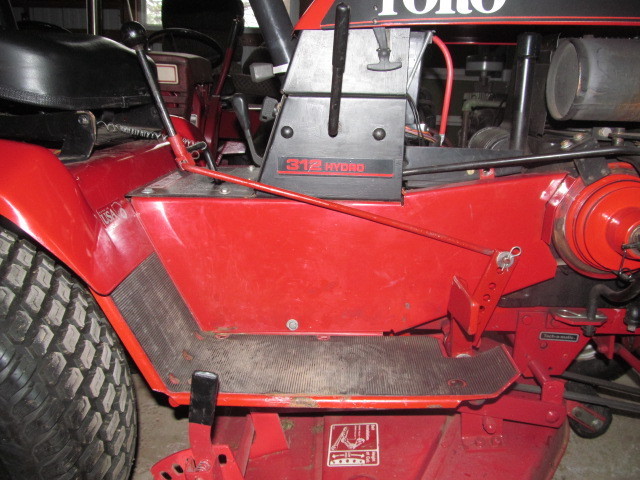

Ed Kennell 47,818 #16 Posted August 16, 2016 For really great motion control, Put a foot control on those hydros Daveo. Frees up a hand to operate the lift for jumping the deck over stump roots and for raising the snow plow and blower. I have foot control on my 312 and 520 hydros. 3 Share this post Link to post Share on other sites

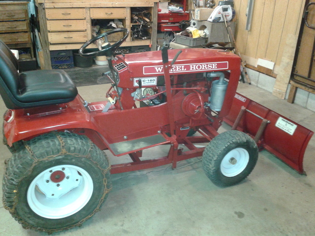

BOB ELLISON 2,983 #17 Posted August 16, 2016 1 hour ago, daveoman1966 said: I like the C-160 Auto for (1)...hand operated motion lever eliminates frequent gear changes (stops) for motion / speed control in grass or gravel. (2) much easier to mow around all the junk..trees...biushes... in my yard, without clutch / gear changes back and forth...just move motion control lever. (3) ability to increase momentum on-the-fly when slamming into a big pile of snow or snow drift. I concede that the 8 speed is better for use with a tiller, but that's all. Just MHO. ps...like the dually on the c160 I'm with you daveoman1966. I have 2 c160 and I can plow with out spinning a tire. I just ease into the snow and it will walk and if I push hard it will fly through the snow. 1 hour ago, daveoman1966 said: 1 Share this post Link to post Share on other sites

BOB ELLISON 2,983 #19 Posted August 16, 2016 This is the perfect snow pusher 1974 C160 auto for me . And I'm starting to bring the 1977 C160 back from the land of the dead. 3 Share this post Link to post Share on other sites

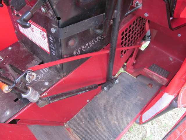

Ed Kennell 47,818 #20 Posted August 16, 2016 Here ya go Bob. I wasn't referring to Matts foot control. This is the control I put on my 312 and 520 and it will work on any hydro with the console located stick like the C-160 and the early 520s. 2 Share this post Link to post Share on other sites
squonk 48,326 #21 Posted August 16, 2016 Notice in this pic. I had a parts tractor that I robbed the hydro control out of. cut it and fabbed it on the hyd. lift control. I can steer with the right hand and drop a couple of fingers down and run the lift. Meanwhile I run the motion control with the left. Reminds me of an old dozer! 3 Share this post Link to post Share on other sites
