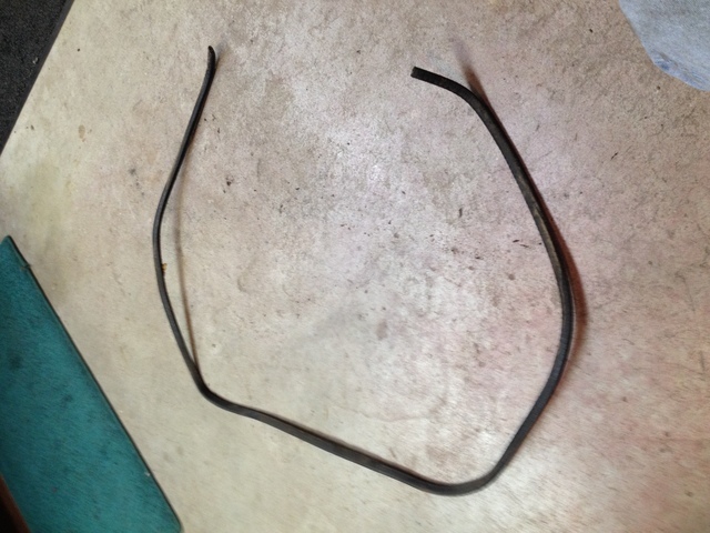

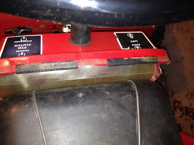

TDF5G 2,074 #17 Posted August 15, 2016 (edited) 20 hours ago, Wishin4a416 said: I use the old edging from seats. The beaded stuff that holds the vinyl to the seat pan. I scrapped 2 or 3 seats and kept the edging. 16 hours ago, Lane Ranger said: I save pieces of the old binding that went around the metal seat pans with the plastic foam seats. Works very well as a hood to dash cushion! This is what I've found to work very well also. Here is a pic one of my tractors that PO had installed. And a pic of a strip of seat edge trim that I saved from an old seat. I honestly don't remember what the original stuff that was on it looks like. You can see where the original was in my pic. When I was a kid, I remember my dad used to replace it with self adhesive foam weatherstrip occasionally. I've tried that and foam camper shell tape too. Doesn't last. Maybe someone has a pic of the original stuff. I'm just curious what it looked like. Edited August 15, 2016 by TDF5G 4 Share this post Link to post Share on other sites
