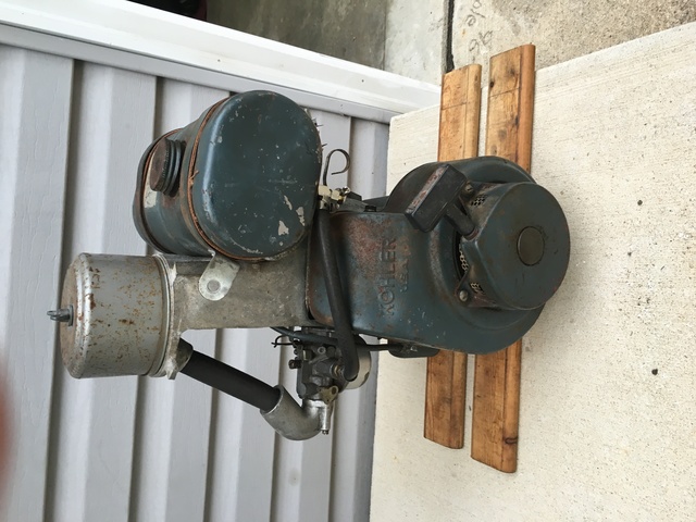

Michael D Conley 148 #5 Posted August 11, 2016 I just finished one today. Replaced the Techy with a k91 Kohler. The pulleys would not interchange so I had to pick up two 3/4 ID. Then I had to pull the flywheel from the Kohler and run an additional wire to the condenser from the kill switch to shut it off. I also had to tap the exhaust port to run the black pipe for the exhaust. Piece of cake! Share this post Link to post Share on other sites
