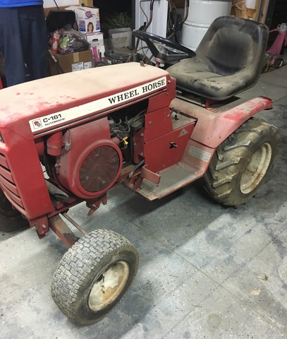

tywilk02 28 #1 Posted August 8, 2016 I ran up on a c-161 auto guy says it's been setting I'm his garage under a work bench since 1992. tractor seems to be in great original condition. To sweeten the deal he also has a snowblower and 48" mower deck to go with it. Any special steps I need to take when prepping it to run again as it is my first hydro model? 1 Share this post Link to post Share on other sites
Mike'sHorseBarn 3,679 #2 Posted August 8, 2016 Check/Change Fluid and filter in the transmission. If I remember correctly the automatic transmission on that model takes 10w-30 motor oil, but check the manual to be sure. 4 Share this post Link to post Share on other sites
elliot ness 1,916 #3 Posted August 8, 2016 Yup change the rear end fluid and filter, and motor oil, and presto, your running for many years to come 1 Share this post Link to post Share on other sites
WHX?? 58,043 #4 Posted August 8, 2016 Use quality Wix or Napa filters and if you do/can run 10w30 it's been said the snythetic is better. I wouldn't know for sure as thats all i have ever run in a Eaton 1100 is Mobil 10w30 syn. with no problems. 1 Share this post Link to post Share on other sites
Tankman 3,528 #5 Posted August 8, 2016 Use synthetic! NAPA has the filter! 1 Share this post Link to post Share on other sites
953 nut 69,073 #6 Posted August 8, 2016 NAPA filter number is 1410. Since it has been setting that long I think new belts and a fuel line and filter would be a good idea too. 3 Share this post Link to post Share on other sites
Mike'sHorseBarn 3,679 #7 Posted August 9, 2016 See I learn all the time at red square! I never used synthetic in my hydro transmissions, just standard 10w-30. Will try synthetic in my 1076 next time! 1 Share this post Link to post Share on other sites

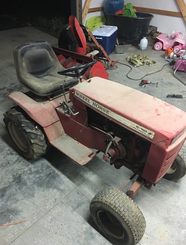

tywilk02 28 #8 Posted August 9, 2016 (edited) Well there she is. First a bath and then a fluid and filter change. Edited August 9, 2016 by tywilk02 11 Share this post Link to post Share on other sites
Retired Wrencher 6,974 #9 Posted August 9, 2016 tywilk02 Definitely clean it up to see where you are. Some times the hydro lines leak. Keep an eye on that. Take your time look every thing and it looks like it will be a great tractor for you. You have the power in the 16 to do a lot of work. Enjoy it. Looks like a keeper. Share this post Link to post Share on other sites
oldredrider 2,553 #10 Posted August 9, 2016 Personally, I would NOT put synthetic oil in that transmission. With synthetic oil, you will discover all seals and maybe gaskets will seep/leak. Conventional oil will be fine. Share this post Link to post Share on other sites
rmaynard 17,572 #11 Posted August 9, 2016 Very nice tractor. And with hydro lift as well. As Paul said, synthetic may cause leaks. I put fully synthetic oil in my 1996 416-H with 1600+ hours (Eaton 1100) with no problem. However, I switched an automobile engine with 100,000+ miles from regular oil to fully synthetic, and it leaked like a sieve. It all depends on how good your seals, o-rings, and gaskets are. @Mike'sHorseBarn Your 1076 uses Dexron II or III. I would continue to use that and not switch unless your transmission has already been fully flushed, cleaned and running with regular oil already. Share this post Link to post Share on other sites

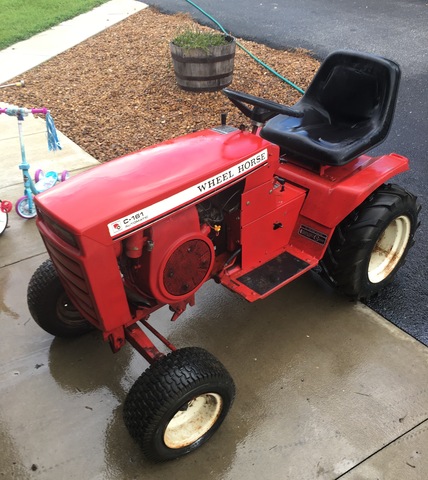

c-series don 12,420 #14 Posted August 12, 2016 Those C-161 autos are a dime a dozen and not worth much so therefore you should probably sell that baby to me!!! Ha!Ha! Rare to find an unmolested one, good for you. Please post pics of that beauty all cleaned up. 2 Share this post Link to post Share on other sites
tywilk02 28 #15 Posted August 12, 2016 Still needs some scrubbing and the wheels have some surface rust. Now I'm waiting on a fuel shutoff valve and an idler pulley spring, and we will be up and running. I've got the hydro draining as we speak and new oil and filter waiting patiently beside it. 4 Share this post Link to post Share on other sites
