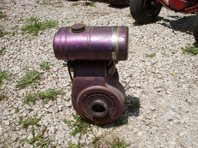

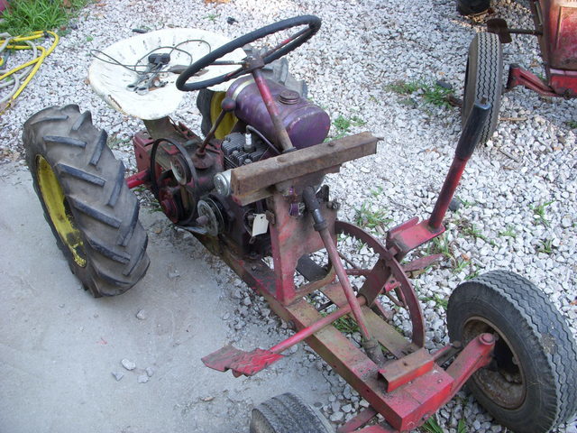

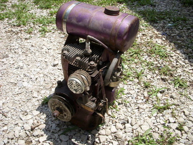

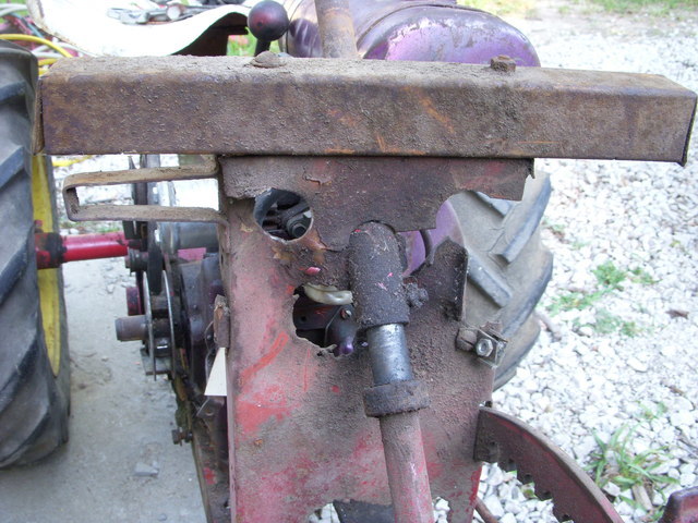

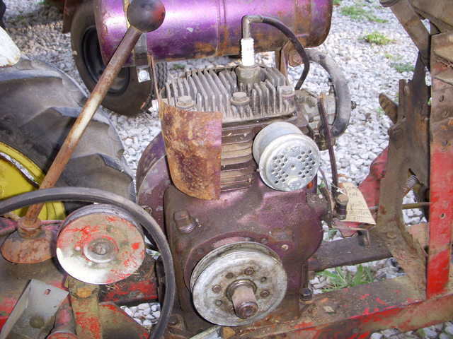

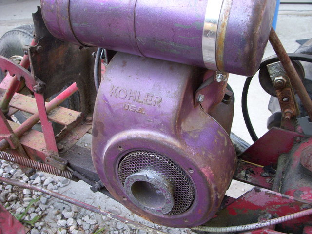

T-Mo-(Moderator) 4,852 #1 Posted July 29, 2016 If anyone remembers "Festus", the sad sack of a 401 that I picked up via Steve via ebay. I pulled the engine off last night and trial fitted the replacement, a K90 (see images below). It bolted up just fine. Now comes the real work. The hood has been butchered and the steering support bracket that bolts between the frame and hood has been hacked upon also. So, that bracket and hood will require a bit of feddling and welding. I was going to just remove the hood and get her going and driving, but the way the previous owners attached that bracket the hood, it's now permanently attached. So, I have to see what needs to be done to remove it from the hood. Oh, well, what can you expect for $50. 1 Share this post Link to post Share on other sites

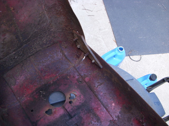

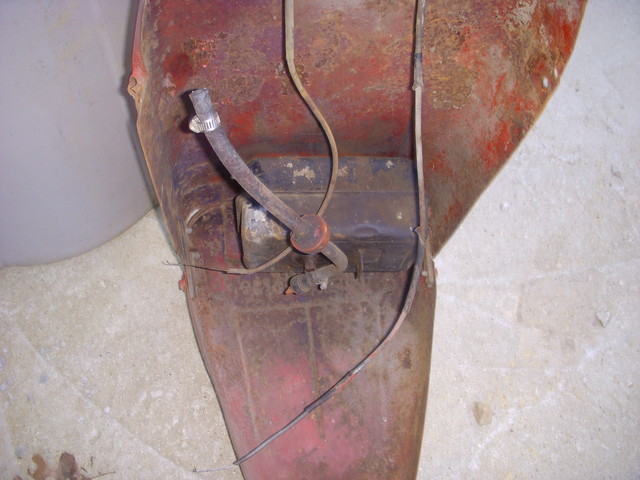

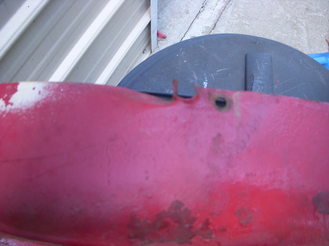

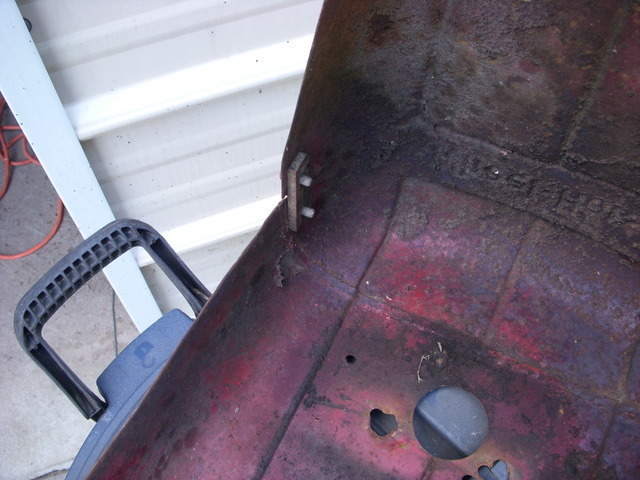

T-Mo-(Moderator) 4,852 #2 Posted July 30, 2016 I got the hood separated from the hood support bracket, which is what I believe it's called in the parts manual. Engine doesn't have spark, so I have to dig into that, maybe today. The hood came apart at the grille, so someone put brackets on the inside to secure that area. That needs to be fixed as well. Share this post Link to post Share on other sites

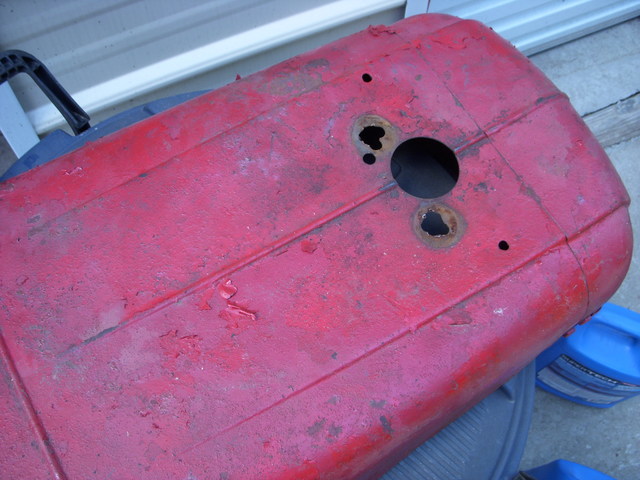

T-Mo-(Moderator) 4,852 #4 Posted July 30, 2016 Hood is stripped of all it's accessories, except the "fix" for the corner seams. It will be pressure washed, stripped of all it's paint and holes plugged up and seams welded, plus straightened in the areas it needs it before primer and paint. 4 Share this post Link to post Share on other sites
T-Mo-(Moderator) 4,852 #5 Posted July 31, 2016 I know it seems like I have been talking to myself in this thread, but I know a few members here have visited it. So, question of the day: According to the information I'm finding on the K-91, it should take a RJ8C spark plug. I bought one yesterday and the thread size is too small. It has a Champion D21 plug in it. Is this what should be in a K-91? 1 Share this post Link to post Share on other sites

clueless 3,403 #9 Posted August 30, 2016 The three k-91 that I can get to right now, two have champ-J17LM, the other champ-J19LM. All are 14mm thread diameter, and 9.5mm (3/8th) thread depth. Also found a NGK BM6A in the spare parts box, same diameter and depth. The new champion plugs have a R before the letters and numbers, not important unless you got a old radio on you tractor. Chris. 1 Share this post Link to post Share on other sites
wrightorchid 261 #10 Posted August 30, 2016 I kinda like that 70's purple disco vibe of the engine!! Share this post Link to post Share on other sites

T-Mo-(Moderator) 4,852 #13 Posted September 4, 2016 Engine sounds pretty good and all the gears work. But, the more I dig into this, the more I see where previous owners butchered and jerry-rigged things, like adding a bracket to move the tensioner pulley on the drive train instead of getting a smaller belt. Both sides of the frame has been cut for some reason. The hood support is really messed up, I'm hoping it can be welded and fixed. Hood has numerous holes, which needs to be plugged. It looks like one axle seal is leaking. Oh, well. It's a project for sure. 1 Share this post Link to post Share on other sites
