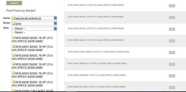

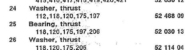

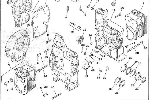

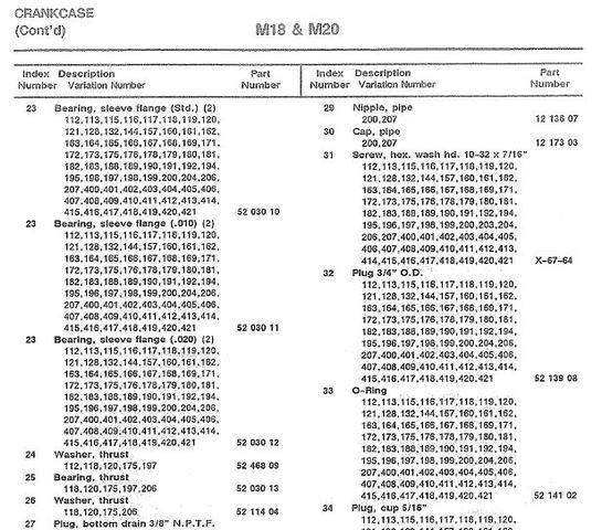

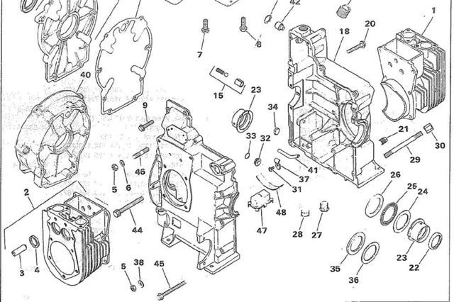

pfrederi 19,936 #8 Posted July 29, 2016 (edited) Mag 18's did NOT have ball bearing on the cranks. Only a very few had thrust bearings. On most the only thing taking the end loading from a WH PTO is the tiny flange on #23. You need one with 24-26 if you want to use a manual PTO. Out of many many spec numbers only the very few in the image used the trust bearing. Electric PTO's would work on any M18 Wheel Horse only used the M18 on the 418a in 1987(i have one) The Spec # is 24510. When you look it up it has the trust bearing set 24-6 and is one of only 5 variants (#118) out of 182 spec #s that have them. Edited July 29, 2016 by pfrederi 2 Share this post Link to post Share on other sites

pfrederi 19,936 #11 Posted July 29, 2016 The Spec and serial # should be on part #12 But it was only a sticker not stamped (like Techies and B&S). At the moment I can't figure anyway of determining if it has the thrust bearing from the outside Share this post Link to post Share on other sites

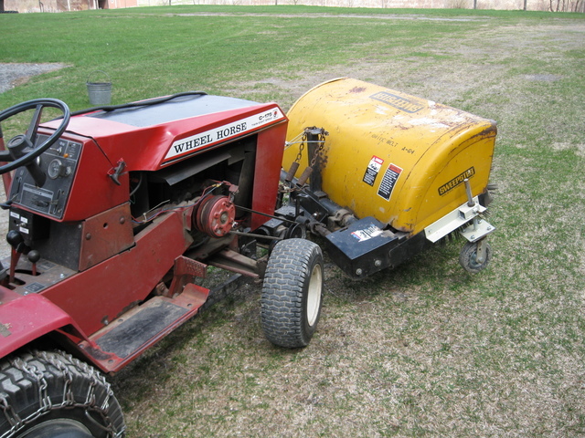

pfrederi 19,936 #12 Posted July 29, 2016 I replaced a blown KT17 in a C-175 with a very well used KT17 from a John Deere 317. Deere didn't spec thrust bearings in their KT17s. I picked up an electric PTO and it runs my sweeper just fine. 3 Share this post Link to post Share on other sites

Stike 204 #14 Posted July 29, 2016 Thanks again for the info and diagrams i'll check that tag when I get off work, but I doubt it will be legible, probably need to find electric pto and use tractor for grading till I find one. Share this post Link to post Share on other sites

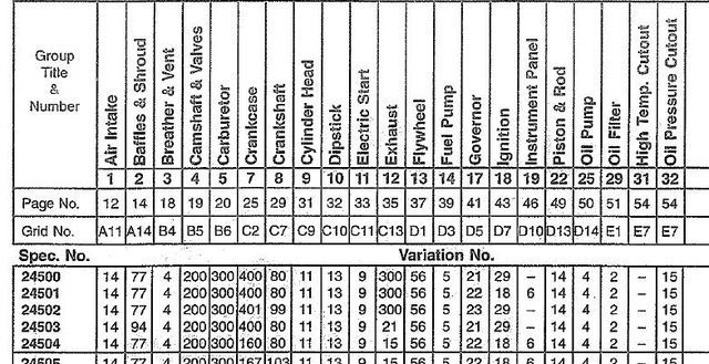

pfrederi 19,936 #17 Posted July 29, 2016 6 minutes ago, Stike said: Amazingly the tag is in good shape, it says model no. M18S spec no. 24500 serial no. 1527315146 any help identifying this would be much appreciated. Doesn't look promising Spec 24500 is variation 400 for the crank case. The crank case section doesn't show variation 400 as using the thrust bearing. Checked the Kohler site 24500 is a basic engine spec, not made for any particular user. Probably a service/replacement engine. Sorry.... Share this post Link to post Share on other sites
