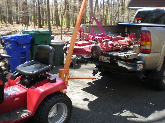

JoeM 10,318 #2 Posted July 28, 2016 Never drove over one. I installed a small hoist in the barn and use it to raise the front end and roll out the deck under the front wheels. Then I lower and push the tractor back and use the hoist to raise the front of the deck and hold it while I service. This made it a more desirable job. 5 Share this post Link to post Share on other sites

Bigfish 146 #12 Posted July 28, 2016 So far we are at 50/50 to drive or not to drive over the 48" deck. I like the lift idea. Do you have a pic of that lift setup oiluj52? Share this post Link to post Share on other sites

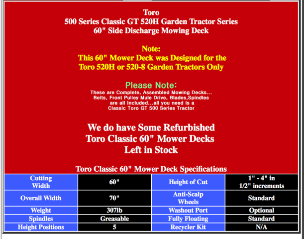

TDF5G 2,074 #15 Posted July 28, 2016 My brother has a 520xi with 60" deck. I remember he said that he read somewhere the deck was about 300 lbs. His has the rollers that turn 90 degrees so you can roll it under the tractor. It's bad enough wrestling my 36" and 42" decks around. Can't imagine dealing with anything bigger. But the tach-a-matic does make it easy to remove and install IMO. Share this post Link to post Share on other sites

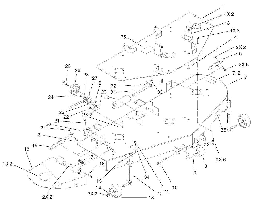

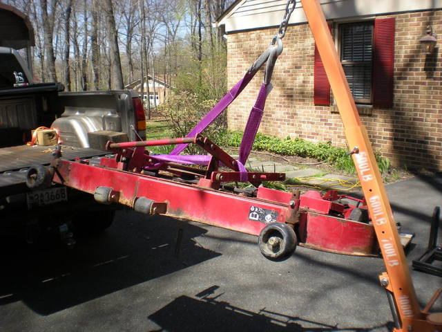

shallowwatersailor 3,222 #16 Posted July 28, 2016 3 hours ago, WHX7 said: I'm likin John's (or Toro's) idea of the wheel, Any one got a pic of a 'xi deck with the wheel? Now take it one step further and use swivel casters? Would be alot easier to move around a shop floor...My 48 is heavy enough not to mention the 60's gotta weight a ton. I can't find photos of just the deck but here are two when I unloaded it from my truck. The front gage wheels can swivel 90 degrees on the 5xi 60" deck, raise the rear gauge wheels, and then lower the small wheel that is in the center. 3 Share this post Link to post Share on other sites
WNYPCRepair 1,924 #17 Posted July 28, 2016 2 hours ago, TDF5G said: My brother has a 520xi with 60" deck. I remember he said that he read somewhere the deck was about 300 lbs. His has the rollers that turn 90 degrees so you can roll it under the tractor. It's bad enough wrestling my 36" and 42" decks around. Can't imagine dealing with anything bigger. But the tach-a-matic does make it easy to remove and install IMO. 307 pounds 1 Share this post Link to post Share on other sites
