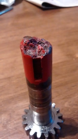

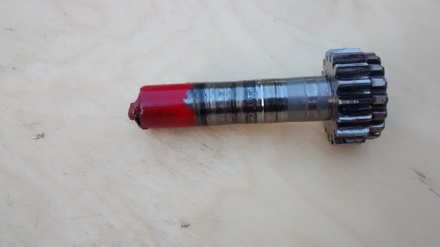

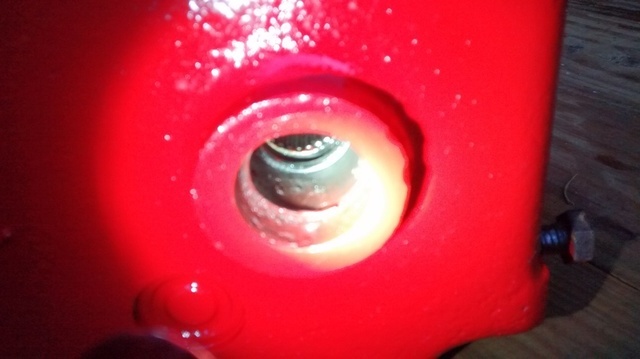

MAH 50 #8 Posted July 19, 2016 Here's a close up of what is left of the end of the shaft. Thankfully when I took the case together the other day the pulley was poorly welded and I was able to use a drift to get it off. 1 Share this post Link to post Share on other sites

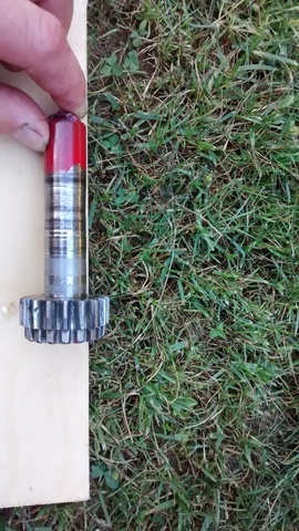

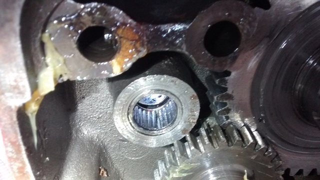

stevasaurus 23,816 #9 Posted July 19, 2016 (edited) Great pictures MAH. I would replace that input shaft. In a couple of the pics, you can see that the shaft is worn where the one bearing disintegrated. This may mean that a new seal will not work on the shaft and will leak. This is too easy to replace. Send a PM to @racinfool40 (Mike), if he does not have one, I do. If you can save the pulley...excellent. The bearings and seal you need to replace...KOYO or Torrington B-1212 bearings (2) and SKF 7410 for the seal (1). These are available from NAPA or Motion Industries. The inside bearing should be placed so it is flush with the rim of the inside case...the outer bearing is recessed enough to let the seal be flush with the outside of the case. The gasket for the transmission halves is a #3912, available from TORO for about $6. Do you need a copy of the transmission manual? I also have some videos of putting the trans together if you like?? Edited July 19, 2016 by stevasaurus 1 Share this post Link to post Share on other sites
