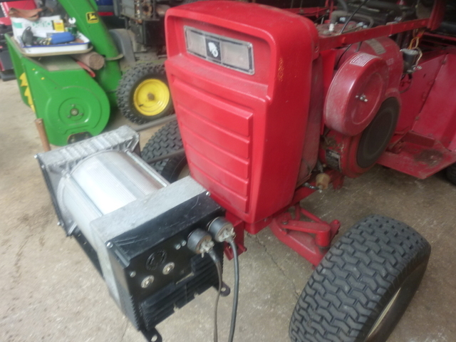

Rob R
Harbor Frieight Gen Set on a GT14
elcamino/wheelhorse

Rob R
8 hours ago, elcamino/wheelhorse said:
Rob which generator did you purchase? I was looking at HF earlier and it showed a 7200/ 10,000 surge for $299.an change . The picture looked some what different than yours . Just wondering.
Yup that's the one, mine looks different since I purchased mine about 12 years ago.... still working fine....
Rob R

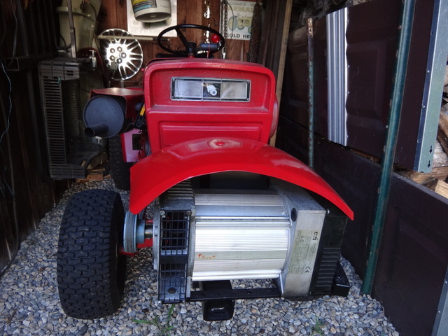

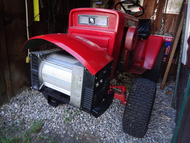

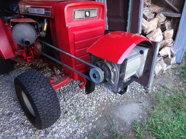

Final touches to the install, a hood to keep the rain and snow off.... intend to leave the gen set on the tractor so that when and if an outage occurs all I have to do is start the GT14 and hit the PTO switch. Note: hood is made from a old Sears Suburban surplus fender, used etching primer and Sunset Red rustoleum.

Basically agree Squonk with one exception, I need to periodically run my well pump and charge the pressure tank so the "girls" can go potty.... the H/F unit I am turning is 5 KW so it can handle this important chore.
JC 1965
Great lookin setup and I'm sure it will be very handy to have around. Thanks for sharing the photos.     :thumbs2:
