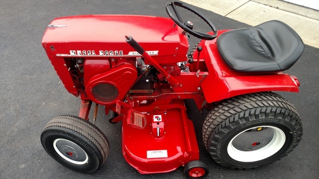

RedRanger 1,470 #16 Posted July 7, 2016 Did someone mention an 867? Technically a 6 speed though. At least that's what the hood decals say. The two in reverse didn't count I guess????? 8 Share this post Link to post Share on other sites

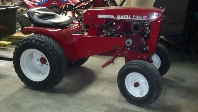

ACman 7,728 #17 Posted July 7, 2016 Does this look like a long frame, there's no description in the ad . It's sure pretty . 6 Share this post Link to post Share on other sites
Terry M-(Moderator) 2,302 #18 Posted July 7, 2016 That does appear to be a long hood on that one, ACman. 5 Share this post Link to post Share on other sites
RedRanger 1,470 #19 Posted July 7, 2016 2 minutes ago, ACman said: Does this look like a long frame, there's no description in the ad . It's sure pretty . Yes, that's a long frame. Compare the hood length to the 867 above and the extra space between the front tires and the deck. Didn't WH make a short frame square hood 10 or 12 horse in 1966 or 1967? I thought I've seen one? One year only deal? It was a three speed I know. 4 Share this post Link to post Share on other sites
ACman 7,728 #20 Posted July 7, 2016 Yes , I see . But it does look to be a 67 model with the decales ? 2 Share this post Link to post Share on other sites
RedRanger 1,470 #21 Posted July 7, 2016 1 minute ago, ACman said: Yes , I see . But it does look to be a 67 model with the decales ? 1067 or 1267 Was the 1055 a short frame? These look short? Pop a 6 speed in one and you're set. 6 Share this post Link to post Share on other sites
