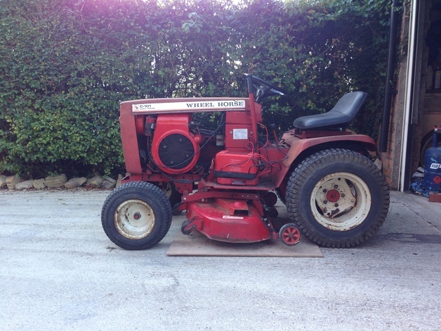

Horse46 519 #12 Posted July 8, 2016 On 7 July 2016 at 4:10 AM, vmen84 said: Would you happen to have a picture? I found one earlier today the guy said it was possibly a 36 inch deck but I'm not sure. This is my C101 with a 42 side exit deck, it cuts nice. B4 and after a motor swap n refresh. It's my first and only one and I love it! 4 Share this post Link to post Share on other sites

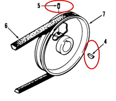

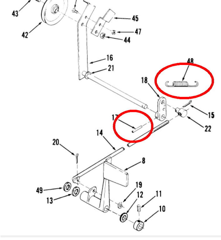

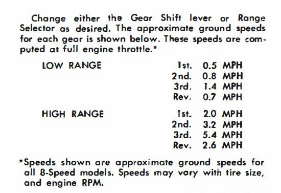

rmaynard 17,578 #15 Posted January 11, 2024 Just so you know what your actual speed should be, here is a cut from the manual for all 8-speeds. So, with that in mind, start by replacing your worn belt. Check your tension spring on the the clutch to be sure that it is pulling the belt tight. Make sure that the pin in the idler arm is not sheared keeping the belt from tightening. Check to be sure that the input pulley on the transmission is not slipping. Check for missing Woodruff key. Next check to see that your hubs are not slipping on the axles. Be sure that the hi/lo range shifter is in the hi range. These are all of the mechanical things that I can think of that might be a problem. 2 Share this post Link to post Share on other sites

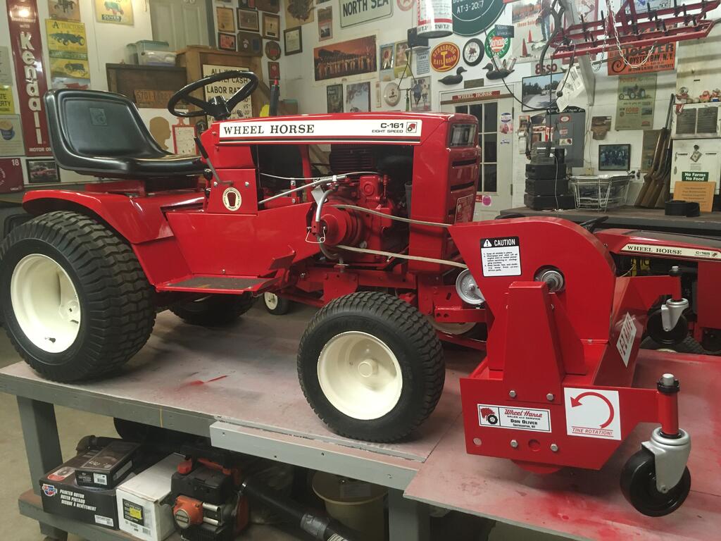

c-series don 12,421 #18 Posted January 12, 2024 Well I’d say once you get the mechanical issues straightened out, restore it. Especially if you have the time and know how. I got this C-161 8-speed and it was literally a basket case. Most of it, except the big pieces was in milk crates. 1 1 Share this post Link to post Share on other sites

Lagersolut 802 #20 Posted January 12, 2024 (edited) 1 hour ago, c-series don said: Well I’d say once you get the mechanical issues straightened out, restore it. Especially if you have the time and know how. I got this C-161 8-speed and it was literally a basket case. Most of it, except the big pieces was in milk crates. C-160 8 or a C 161 8 was on my wish list for years never found one I wanted to jump on - 5 years ago a 416 8 jumped off a page on market place so I restored that as a worker - got the K 34116hp Kohler I wanted ....its a beast Edited January 12, 2024 by Lagersolut 1 Share this post Link to post Share on other sites
