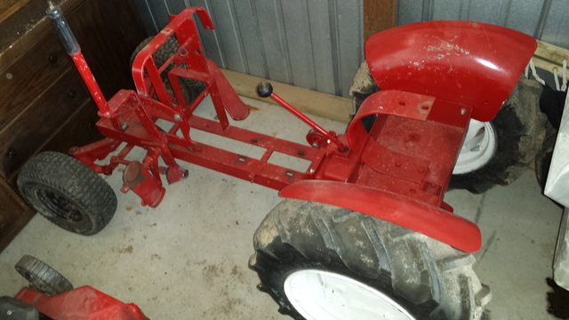

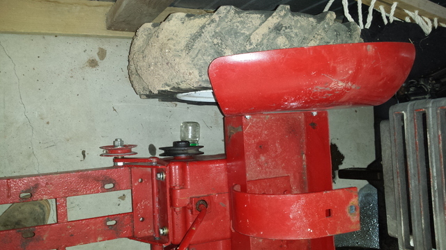

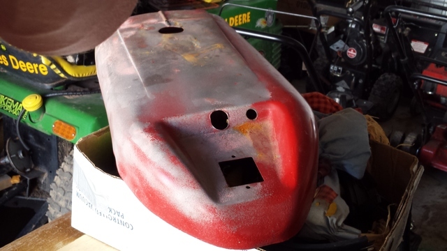

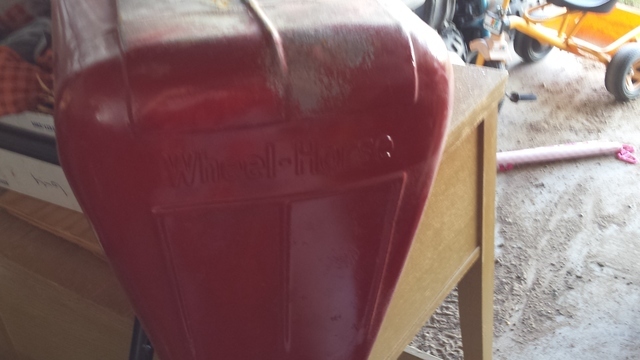

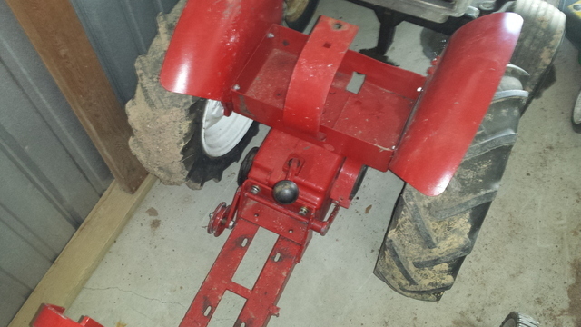

Dnalsae 2 #10 Posted July 6, 2016 Here are some pictures. I hope these help. Sorry about it being in pieces as I was in the middle of restoring it. 1 Share this post Link to post Share on other sites

wallfish 20,053 #12 Posted July 6, 2016 Bob got it right. Everything but the hood looks 551 to me Hood is 1960 Share this post Link to post Share on other sites
Dnalsae 2 #13 Posted July 6, 2016 Well that puts me in a predicament then doesn't it. I guess I could look for a correct hood. But for now I will make it look as good as I can. Share this post Link to post Share on other sites
Racinbob 12,996 #14 Posted July 7, 2016 Please don't let the hood discourage you. That's a dandy you have there. You could put 60 controls on it and be good to go or sooner or later a 61 hood will come along. Richard is spot on in post #8. There are far fewer true 'originals' out there than many want to believe. I do love originals and seeing folks strive for accuracy but there's nothing wrong with a combination of years.. That's really one of the many great things about these little tractors. So many parts are interchangeable over the years. Share this post Link to post Share on other sites
Andrew D. 23 #15 Posted July 7, 2016 (edited) look at the hood support. i'm not an expert and could be wrong, but isn't that the same support as an rj 58/59 would have? any suburban '60 or '61 i have ever messed with had a different support more like a firewall. Edited July 7, 2016 by Andrew D. Share this post Link to post Share on other sites
Dnalsae 2 #16 Posted July 7, 2016 Ok thanks everyone. I am going make it a 400 with a 2 piece transmission. As I have already aquired a k91T 4 hp kohler. Someday I will find a 5.5 hp tecumseh and a 551 hood. I will just catch hell from the old timers at the tractor shows that I attend until it is perfect. Share this post Link to post Share on other sites
Racinbob 12,996 #17 Posted July 7, 2016 9 minutes ago, Dnalsae said: Ok thanks everyone. I am going make it a 400 with a 2 piece transmission. As I have already aquired a k91T 4 hp kohler. Someday I will find a 5.5 hp tecumseh and a 551 hood. I will just catch hell from the old timers at the tractor shows that I attend until it is perfect. No, you won't. You'll just get a lot of praise for a nice tractor. I'm one of those 'old timers'. The first Wheel Horse I drove was a brand new 400 that my Dad bought new. I recently finished restoring that very same model and no, it's not 100% original. It's the way I wanted it. The 500 Special I'm doing now won't be per the books either. 19 minutes ago, Andrew D. said: look at the hood support. i'm not an expert and could be wrong, but isn't that the same support as an rj 58/59 would have? any suburban '60 or '61 i have ever messed with had a different support more like a firewall. I can see why you think that but no, it's not an RJ. The 551 made room for the battery with that frame. 1 Share this post Link to post Share on other sites
