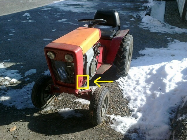

Does anyone know what the flat spot and holes are for on the sides of the grill of a 953/ 1054?953grill.jpg

I believe that the  37 inch snowblower built for the 1054 had a piece that went in there for the snowblower lift.   The mounting arms and long blot between the  mounting arms.

The snowthrower idler pulley mounts there.
Description on page 9 on the right side after the 1st "Note"
Photo on page 11.

mystery solved lol I have never seen a snow blower on a 953 / 1054
