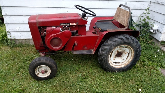

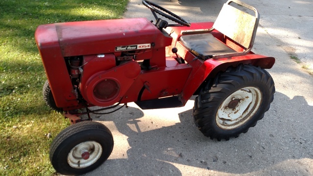

TIGman 2,006 #1 Posted June 24, 2016 Probably already been covered in another thread, but just wondering what kind tire treatment you guys are using on "original" tires to keep them in shape? Just picked up the 1054 with nice original back tires, would like to keep them that way. Thanks!! Share this post Link to post Share on other sites

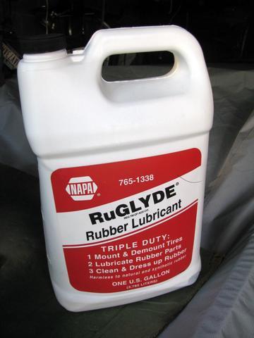

TIGman 2,006 #4 Posted June 24, 2016 Here's the item I was thinking of. 3 Share this post Link to post Share on other sites
KC9KAS 4,746 #5 Posted June 24, 2016 42 minutes ago, TIGman said: Here's the item I was thinking of. I just bought a jug of the RuGLYDE and it worked very well installing and sealing new tires. The container said it can also be used on rubber to clean it as well as condition it. I also bought the little "mop" brush to apply the product to the tires...I'm operating just like the big tire shops now! 6 Share this post Link to post Share on other sites
RedRanger 1,470 #6 Posted June 25, 2016 I've used RuGlyde as well as tire paint. Start with the RuGlyde. Napa sells it. I lathered up the tires and put them in garbage bags for about a week or two to soak. It softened them up and conditioned the tires real well. Took 30 years off their age. I wouldn't go to the tire paint unless the tires are really really dry, cracked, or discolored. Last resort. 3 Share this post Link to post Share on other sites
TIGman 2,006 #7 Posted June 26, 2016 I picked up some RuGlyde after work Saturday and used on the 1054 tires when I cleaned her up. I really liked the results. 6 Share this post Link to post Share on other sites
RedRanger 1,470 #8 Posted June 26, 2016 Just keep applying it and let it soak in. It won't harm anything. 1 Share this post Link to post Share on other sites
