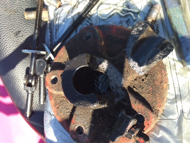

Deadguy 864 #1 Posted June 17, 2016 This is bad, isn't it? 2 Share this post Link to post Share on other sites
oldredrider 2,553 #2 Posted June 17, 2016 It's nothing that money can't fix! 3 Share this post Link to post Share on other sites
Deadguy 864 #3 Posted June 17, 2016 It is a 1972 Raider 10 with 1" axle shafts. I was able to find replacement axle shafts on eBay, but 1" hubs are evading me. Well, other than the guy on eBay that is selling them for $100! I have found several hubs on various websites that sell parts, but none of them say what size axle they are for. Does anyone know what Wheel Horse or Toro axle hub part numbers are for the 1" size? Thank you! Also, I thought these things were supposed to be tough! This busted while pulling a chisel plow through soft ground. 1 Share this post Link to post Share on other sites
N3PUY 1,031 #4 Posted June 17, 2016 And it's ONLY 44 years old! That didn't just happen. That hub has been loose for years to be that beat! When did you last tighten the set screws? 6 Share this post Link to post Share on other sites
Deadguy 864 #5 Posted June 17, 2016 That would have been last summer when I changed the tires.... Share this post Link to post Share on other sites

Achto 32,462 #8 Posted June 18, 2016 (edited) 4 hours ago, Deadguy said: Does anyone know what Wheel Horse or Toro axle hub part numbers are for the 1" size? I believe the part # is cast right into the back of the hub. Looks like 3979. Chances are that your set screw became loose and caused this damage. Edited June 18, 2016 by achto Share this post Link to post Share on other sites

Racinbob 13,119 #10 Posted June 19, 2016 Loose 'for years' didn't cause that. Decades of use and fatigue did. It's possible the set screw was over torqued and caused a hairline crack in the casting and finally it just gave way. Anything can and will break given enough years. It's no reflection on the toughness at all. There will be many at the big show and it looks like Howard will get you fixed up. No need to pay the ridiculous Ebay prices. 2 Share this post Link to post Share on other sites

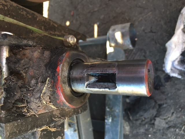

Deadguy 864 #14 Posted June 25, 2016 Just now, mid60's said: Had that happen to my Commando 8. Probably decades of use and being loose. Tightening only put off the inevitable. Took the complete trans. to the machine shop where they cut a new keyway on the opposite side of the axle and a replacement hub and I was good to go. That was 10 years ago. Still going strong. unfortunately, there are cracks in the axle radiating out from the mashed up key way, so the whole end of the axle is structurally compromised. I did find replacement axles, and next is the fun step of removing the transmission, cracking it open, and pulling out the differential assembly. 2 Share this post Link to post Share on other sites

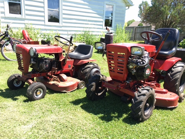

Deadguy 864 #16 Posted July 3, 2016 Howard got me hooked up with a new hub from the big show. I found replacement axles too. I will be moving in a few weeks, so once I get my new shop set up, I will probably do a full transmission rebuild on that tractor, as long as I have it off the tractor. In the meantime, here is a picture of my other two horses to enjoy! 3 Share this post Link to post Share on other sites
