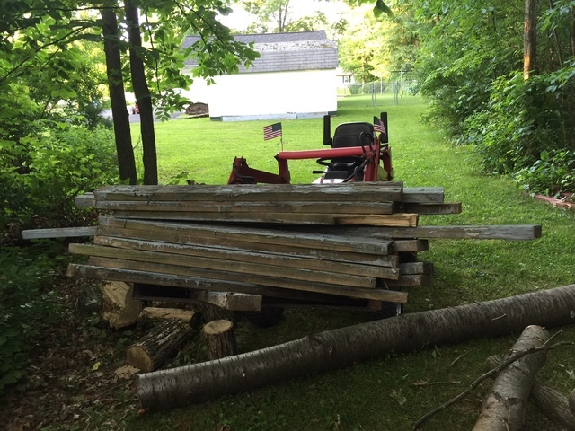

boovuc 1,090 #1 Posted June 16, 2016 One of these lifetimes, I'm going to buy a house and build a deck then stay in it long enough to replace my own work, This has to be the fourth deck I have had to gut and redo in my 59+ years on earth. Anyway, here is the 520 Loader Tractor at work for a change. I cross-stacked the planks and put as many small boards in the bucket then stacked on the ones sticking out and tilted the bucket back as far as it would go. Made around five trips plus used it to unseat a pier they decided to concrete in rather than sit or bolt on. I have no idea how much weight is on it. Most of the planks are 10 to 12 footers We had no snow here over the winter so the loader hasn't had much work since last summer and early fall. It is sporting the Fourth of July flags early. PS...Yes I still have logs to cut and split and fungus removal on the shed roof to complete! :< ) That red birch log weighs a ton! 17 Share this post Link to post Share on other sites

roadapples 6,987 #6 Posted June 16, 2016 That`s just about a full load... Don`t think we`ve herd from you in a while Boo... 1 Share this post Link to post Share on other sites

953 nut 69,070 #8 Posted June 16, 2016 You must have a real heavy weight box on the back, that much PT lumber would make mine pirouette on the front tires like a ballet dancer! 3 Share this post Link to post Share on other sites

boovuc 1,090 #10 Posted June 16, 2016 The rears are BIG. They were bought from a fellow member just a half mile from my house. The rims were welded together like a puller would use. Off hand I can't remember the tire size but they really help stabilize the tractor and are better on the tranny and in steering verses dual setups. The weight box is solid concrete blocks with metal plate to fill the voids in the stock Ark Industries Loader Box. Guessing about 160 lbs +. I haven't been on much due to work constraints. It's been busy where I show up during the day. I am just plain whipped when I get home. I haven't done a Wheelhorse Tractor Project since the 417-8 restore and I haven't bought any since the 417 carcass I used for the rebuild so I've had generally nothing to contribute to the WH cause! :< ) I still get my trout fishing in though! Nothing but bad health would keep me from my streams around here! 7 Share this post Link to post Share on other sites

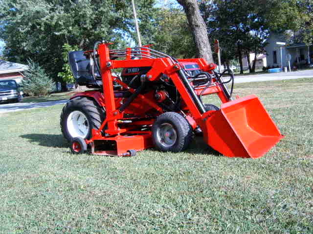

elliot ness 1,916 #11 Posted June 16, 2016 boovuc, you have a great tracor with a nice handy loader, This is my 520 W/ a loader I built from scratch. 5 Share this post Link to post Share on other sites
WHX?? 58,043 #12 Posted June 16, 2016 That sweet Elliot...did you do a thread on the build? Gotta love the way them big fat ags stick out! 2 Share this post Link to post Share on other sites
elliot ness 1,916 #13 Posted June 16, 2016 1 hour ago, WHX61/3 said: That sweet Elliot...did you do a thread on the build? Gotta love the way them big fat ags stick out! Yes I did about 1 year ago every stage of the build. 1 Share this post Link to post Share on other sites

Horse46 519 #15 Posted June 17, 2016 17 hours ago, elliot ness said: boovuc, you have a great tracor with a nice handy loader, This is my 520 W/ a loader I built from scratch. Wow is there a Horse under there? 2 Share this post Link to post Share on other sites
elliot ness 1,916 #16 Posted June 17, 2016 4 hours ago, Horse46 said: Wow is there a Horse under there? Yup sure is 520 H 1990 26x12x12's on the rear, and now with rear wheel wts. and the rear tires wt. 85lbs each fluid filled. I have had many Loader tractors, and this one is so handy. and strong. 2 Share this post Link to post Share on other sites
WHX?? 58,043 #17 Posted June 17, 2016 Mower deck looks pretty high test as well, gotta be alot of weight that horse is carrying ... then put a load in the bucket! You guys don't seem to worry about that too much tho?? 1 Share this post Link to post Share on other sites
elliot ness 1,916 #18 Posted June 17, 2016 9 hours ago, WHX61/3 said: Mower deck looks pretty high test as well, gotta be alot of weight that horse is carrying ... then put a load in the bucket! You guys don't seem to worry about that too much tho?? No I don't worry, the 520's have 1in. spindle, and steer about as easy as any wheel horse ever built, till PS. and I always run 35lbs of air in the front tires and this also helps it steer. I built this loader so that when I start to raise it up it throws the wt. to the rear, I mean the loader is real close to the grill if the tractor, thus as it climbs up it also head to the rear of the tractor. Mine will easy pick up 600lbs. If you would like I can send pics or repost then of the building of it. Share this post Link to post Share on other sites
boovuc 1,090 #19 Posted June 19, 2016 Mr Ness! That is a nice compact build. I love the looks of that creation better than my ARK loader on mine! Wanna swap? :< ) I'll have to check out your build posts! PS..The 520's were the only modern WH/Toro tractors to handle loaders. 1" spindles standard. Gear reduction steering standard. Weight boxes resting on the loader frames. Short of loaders built on the Xi series tractors with or without power steering, I can move my steering wheel without a suicide knob standing still. (without anything in the bucket). The Eaton rears do well with the load on them. I have had the loader on this 520 for four years now and with and without use, I have no axle leaks with that weight bucket on it to date. Not even a hint of oil coming through them. I do change the hydo oil/filter more often as I believe it is susceptible to higher temps than what mowing would do. 1 Share this post Link to post Share on other sites
