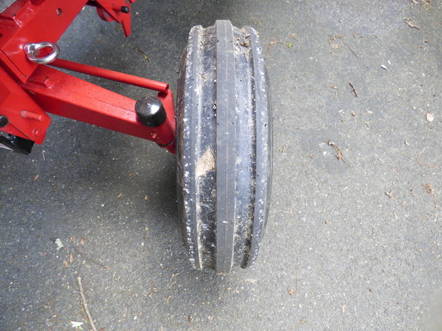

shallowwatersailor 3,222 #4 Posted June 12, 2016 Here are three rib tires on a 4" wide rim. You will need a spacer on the axle to make up the difference in width. And yes, they would look silly on a 6" wide rim. A better choice for the 6" rim would be the Vredestein V-61 five rib tire. 2 Share this post Link to post Share on other sites
