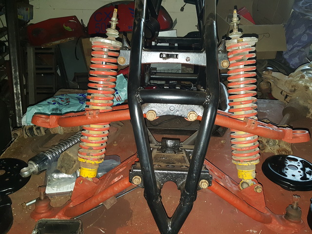

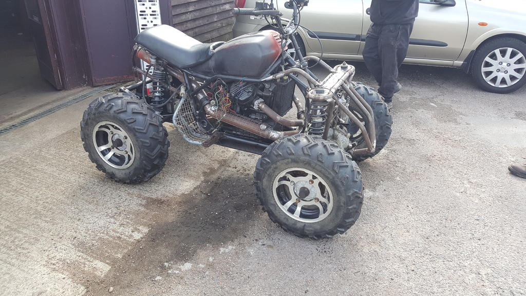

Stigian 1,235 #29 Posted December 14, 2016 On 06/12/2016 at 7:20 PM, pullstart said: Ian, where was the quad previously stored, to get that much rust and corrosion on the suspension and undercarriage parts? I'm starting to think it lived at the bottom of a pond at some point in it's life! Progress has been a tad slow, but MadTrax now has front shocks fitted.. All I had to do was chop an inch odd from the springs, change the top mounts on the shocks and move the shock mountings up a bit on the frame! 1 Share this post Link to post Share on other sites

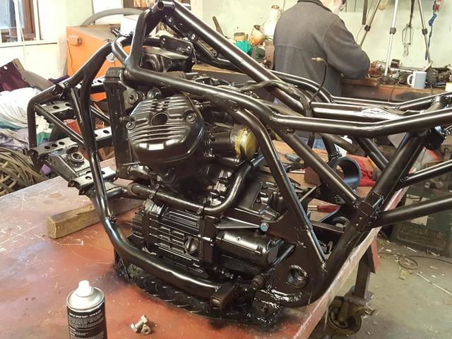

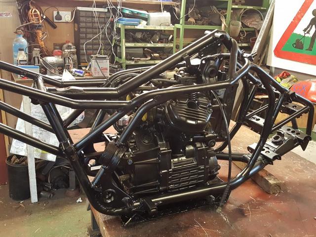

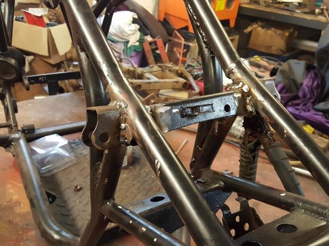

Stigian 1,235 #30 Posted December 19, 2016 Cleaning and painting the engine time had come.. Once the radiator and mountings plus the carbs were off the engine looked a lot smaller.. And a lot cleaner after lots of time with wire brushes on a drill Parts like the fan shroud were very rusty.. But after a lot of cleaning, priming and top coating it looked good along with the radiator.. And the radiator/front engine mount thingy. The engine looks quite good too Before the engine could go back in there was a slight frame mod to do.. As the shock mounts had been moved up.. The strengthening bar between them also got moved up.. Engine in, thanks for your help today Rob should you be reading this. I just need to finish sorting out the rat's nest of a wiring loom! 2 Share this post Link to post Share on other sites

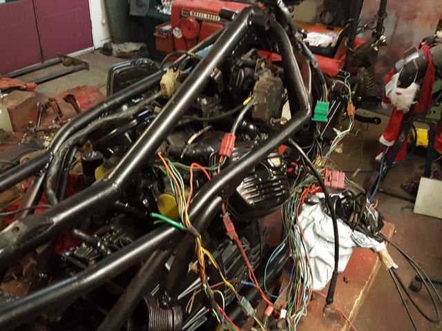

Sparky-(Admin) 25,049 #31 Posted December 20, 2016 Pretty scary wiring harness you have hanging off the motor in the second pic. You plan to weed it out some? Mike..... 1 Share this post Link to post Share on other sites
Stigian 1,235 #32 Posted December 27, 2016 On 20/12/2016 at 0:43 AM, Sparky said: Pretty scary wiring harness you have hanging off the motor in the second pic. You plan to weed it out some? Mike..... Hey Mike, how's you? Yeah the wiring is scary at the mo, I've removed a few wires that are not needed but I need a wiring diagram to sort out the other "unknown" wires so I only keep what's needed to run the engine.. All the front end parts had a session with some rattle cans. A spring looking good in black.. Well, it did look good until I noticed how much I had missed on the other side.. Spring can be a right pain to paint! The front end bolted back on.. The good thing with painting everything satin black is I can just spray over any pain chips without having to mask anything up 2 Share this post Link to post Share on other sites
Stigian 1,235 #33 Posted January 2, 2017 Not a great deal to report as I've not been up the workshop apart from a few hours Friday where my body needed a break from all the festive sitting around! Trying to follow a wiring diagram on a smart phone (printer out of ink) was interesting but I did manage to remove a few more un-needed wires from the loom... It's starting to look less frightening now Just before silly season hit I pulled the gauges out of a box to finish them off.. The glass "eyebrow"/top/bit that actually holds the gauges in (the pods were make from ride on mower headlamps remember) needed a little something to stop them from flying apart during high speed jumps/crashes (delete according to taste/fear/bravery). A bit hard to see from this photo snatched from video footage, but there is a small Allen key bolt that screws through a hole in the lip thingy into a threaded insert welded to the pod body. Gauge pod body's and trim/eyebrow top ring thingys hit with the black stuff.. To finish this update off here's the latest MadTrax video where I play around some more with special effects and a few sound effects as well.. I even do some work on MadTrax 1 Share this post Link to post Share on other sites

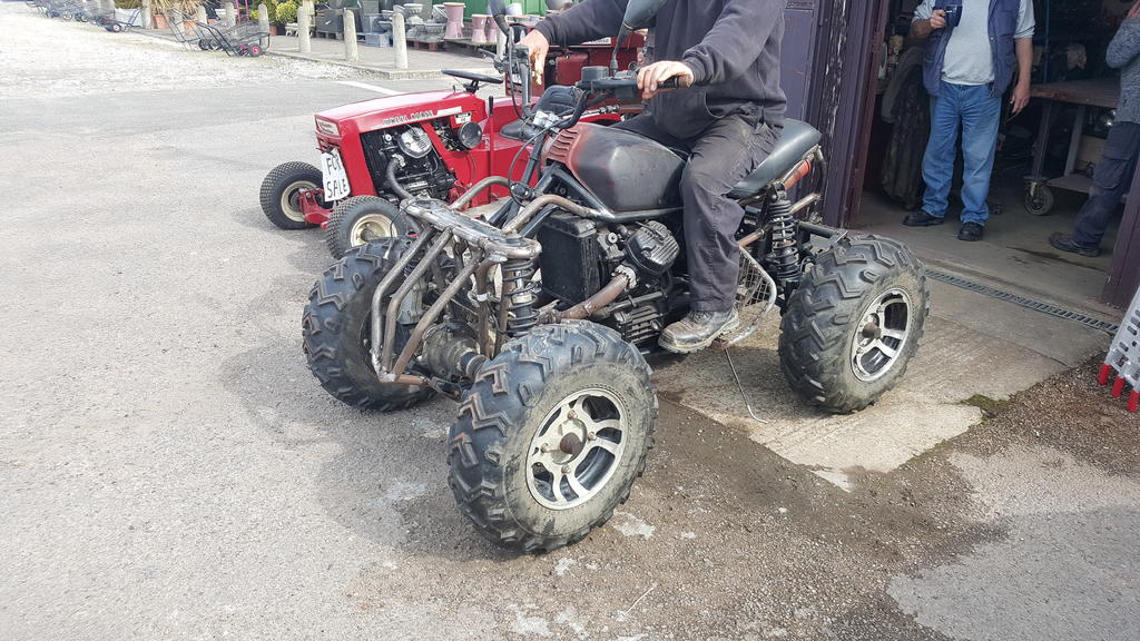

Stigian 1,235 #40 Posted September 13, 2017 On 25/08/2017 at 10:14 PM, elcamino/wheelhorse said: @Stigian I was wondering where you were on the build, I did not realize that you had not posted anything since January. One question about the latest build , when you are finished "Will it cut grass ?" Plenty of space to mount a cutting deck underneeth Jim, though getting drive to it would be interesting.. On 28/08/2017 at 0:56 PM, pullstart said: Are you going to make use of that front differential? It looks great with the new suspension! I am indeed Pullstart, as it's there it would be daft no to take full advantage of it Morning all, bit more of a MadTrax update for you.. Yep, yet more slicing and welding, even more of the same to come The box section under/around the rear diff needed to come out as it just looked rubbish!! Slicing it off in one bit was interesting ! In went some new tube.. A lot of extra tempoary bracing went in to stop things moving.. The big blue tubes hold the rear end off the bench as I had to remove both rear wheels and move the shocks so I could get a cutting disc in.. Not fully welding in yet, but I have added a cross tube between the end of the new rails since this pic was taken.. It was at this point my Murex 165 TradeMig shat it's self and decided it didn't want to produce good welds any more! When using it you can feel it's "pulcing" and just has lost it's amps and doesn't want to penetrate!! So a BIG THANK YOU to Nigel for offing me the use of his welder until I can get mine fixed which will hopefully be some time next week.. Nigel's Mig on the right, naughty Mig on the left! Much welding and the wheels put back on later the rear end looks like this.. Some extra strengthening and tidying up needed but it's looking good. Another big to Nigel for helping me get the new front end lined up and squared up with the rest of the frame.. This took a suprisingly long amount of time... Bracing was added after this photo was taken to keep it in the right place. Time to get serious with the front end.. Not the best of photo's as someone had put an exhaust in the way, but the front is now welded to the rest of it.. I will put a load more strength in this area but it's one of those jobs best done later when the frame is stipped down (again) and I can turn it upside down. So I could do some structural slicing the front diff needed to be moved forward and out the way a bit.. Of course two of the Allen Key bolts came undone with only a small fight, the front two refused to budge and eventually got chewed up.. The only way to undo them without grinding the heads off was to weld a bit of bar to the bolt head and hope the heat would free the thread up.... Which it did. There's no two ways about it, the Quadzilla front strut towers looked ugly, really ugly.. So why not turn it around and make them a feature With yet more tempoary bracing in place and the top of the towers already mostly wrapped in tube, half the O/S strut tower was cut out! Cleaning up the welds was not fun as they were very hard! Fresh tube welded back in to replace the metal I had cut out, and a Nigel holding the rear tube in place.. A close up for you. And a view from the front and top.... By the time we are finished it will look way better and be much stronger than the original Quadzilla strut towers Oh..... Much to my and Nigel's suprise I found the Quadzilla gear/transfer box the other day.. Both Nigel and I thought it had long gone! If I can make it fit in this space, MadTrax will have HI/Low ratios and a reverse.. Well 5 of em 2 Share this post Link to post Share on other sites
Pullstart 69,751 #41 Posted September 13, 2017 This thing just took a huge turn... for the better of course. You'll probably need that traction of 4 lugged tires... so long it doesn't just carry the front 2! 1 Share this post Link to post Share on other sites

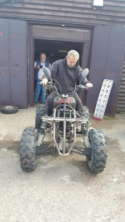

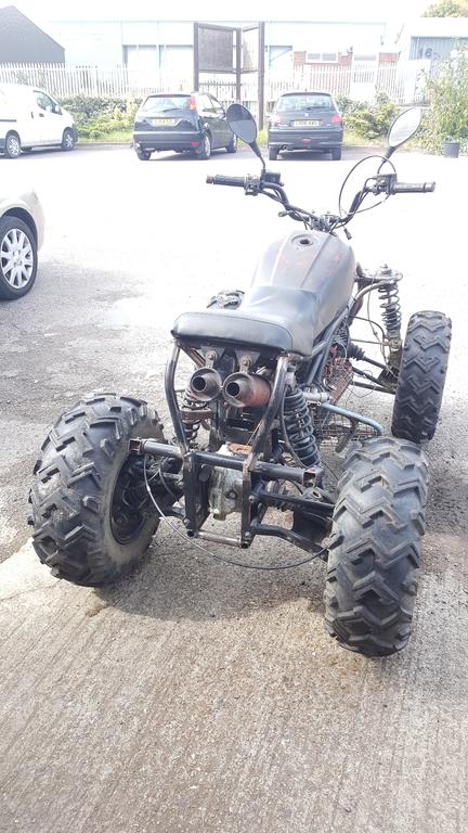

Stigian 1,235 #42 Posted September 24, 2017 (edited) On 13/09/2017 at 5:22 PM, pullstart said: This thing just took a huge turn... for the better of course. You'll probably need that traction of 4 lugged tires... so long it doesn't just carry the front 2! Hi Pullstart, I don't think the front wheels will lift on launch, she's quite a heavy ol girl Owdo all, MadTrax is coming along nicely, along with a lot of new tube the looks have changed as well By only doing one corner at a time the Quadzilla strut towers have gone, I think the tube looks much better. A new nose taking shape. You can also see some new tube connecting the top of the struts to MadTrax's frame just in front of the gas tank.. The photo's don't show it too well but the curves match and line up with other tube.. Nose job finished, not as pointy as the first one and it looks all the better for it... No chance of it digging in and throwing me over the bars now A single tube connects the nose to the frame, hopefully there is still enough space left to get the diff out when I need to When I cut the front off it left four open tubes on the frame, so they needed to be tied into the new front end... The two tower tubes will be joined together, something like this only cut to fit and without the hand to hold it up Oh, here's a few photo's from Thursday when we wheel MadTrax outside to have a look from all angles.. Something that's hard to do when she's up on the bench.. And for your viewing pleasure here's the latest MadTrax video..... Warning!!! It is a bit long! Edited September 24, 2017 by Stigian 1 1 Share this post Link to post Share on other sites

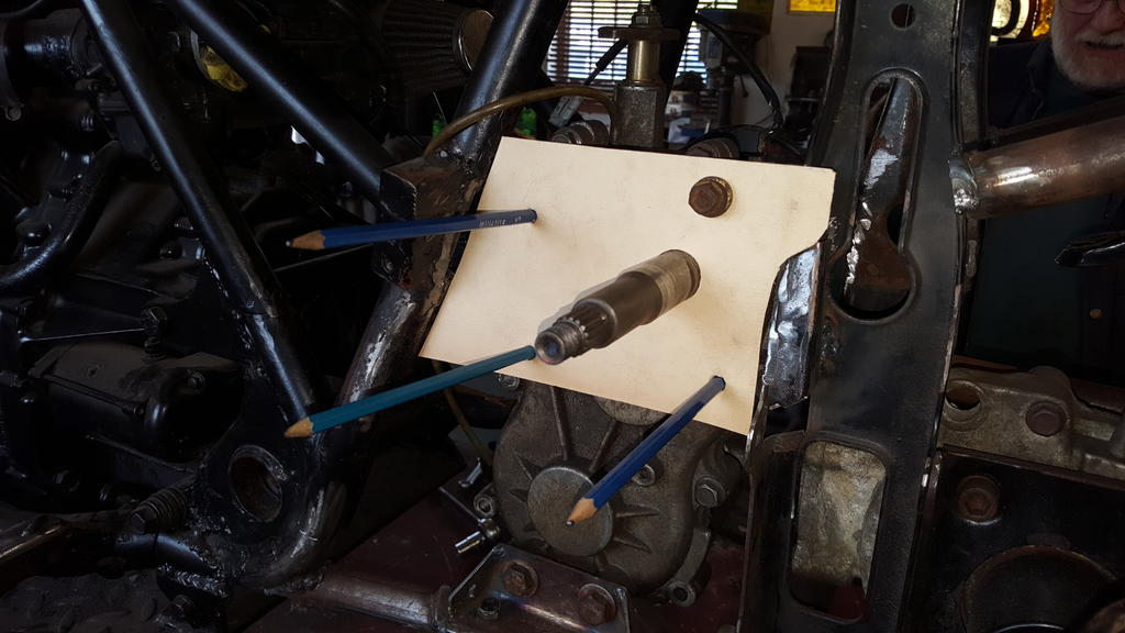

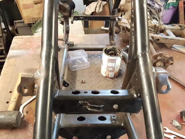

Stigian 1,235 #43 Posted October 29, 2017 Back on the bench the rear end was stripped off, a bit of grinder work later and the transfer box was almost in. By almost, I mean the box fitted in but splines wouldn't quite line up.. By connecting the diff and tranfer box shafts I get drive to the rear diff but it also dictates exactly where the TF box has to go. And this is the point where I need some help guys.. The front and rear came from a 2012 Quadzilla 325E 4x4. The problem is I can't get the rear half shafts out of the diff! All the research I've done says inside the rear end is a crown wheel that has a shaft with splines on each end running through it. The end of the half shaft should have internal splines that push over the "crown wheel shaft" and is held in place by and expanding spring/washer thingy.I can pull the end of the half shaft out of the er.. diff/and or crown wheel case only a certain amount and then it feels like there is an internal "cir clip" holding the shaft in.. Also as you will see from the photo the end of the half shaft has external splines not internal ones like the internet whould have me believe! My thoughts are it does have a diff in the back, but someone has cracked the case open and welded it up to make a "locked" rear end.. There is plenty of signs that someone has been in the rear end before, lot's of mastic type sealer on the case joins! Oh, the diff won't come out of the frame without taking the end of the half shafts out first! To join the transfer box to the rear diff I needed the longest length of slined section from one of the Quadzilla prop shafts.. You might say the UJ was a bit worn! The "coupler" needs a bit of work but transfer box and rear diff joined A shaft with 2 UJ's comes out of the front of the transfer box. Which will fit onto a nice sturdy shaft running forward with bearings to hold it in place. The thin walled white tube is for illustration purposes only The front of the shaft will connect to the front diff via some very strong chain and sprockets. Disclaimer... " The above chain idea has now been changed but I've put it in as it's part of the MadTrax story" Still no luck getting the rear diff out, but I did take the input shaft out to try and see what's going on inside.. No diff inside but both cogs look in great shape. Getting drive from the Honda bike gearbox was always going to be fun as there isn't much space! The only thing I could do was move the transfer box as far back as possible. So out came the Quadzilla battery tray, followed by a slice taken out of a rear strut tower. The transfer box/rear diff coupler limits how far box the TB (transfer box) can be moved back. But notch cut out of the strut tower allowed me to move the TB back a good 1/2 inch.. Not much but it all helps. At this point I still didn't have a working Mig welder and couldn't really do any more on the project, so I tidied the bench and had a think. A change of plan getting the drive to the front er... I keep going to call them "diff's" but they dont have a diff in them! Anyway, you know what I mean. Rather than go the chain and sprockets way I meantioned in my last update, I will be using the Quadzilla drive shafts, all I need is one more UJ tyo get the shafts around the engine. Of course the front part of the exhaust won't fit because of a drive shaft in the way, but hey, it's only metal While on the subject of shafts, this is part of the drive shaft that fit's on the bike gearbox, the problem is the splines inside don't go all the way to the UJ, so I can't just cut it to length! The only way to do it is to slice a bit out the middle and weld the splined section back on much closer to the UJ. I need to shorten this so it will fit onto the gearbox splines and leave enough room for the UJ on the shaft that runs from the TB to the front axle. To make it easier to line the two bits back up for welding I needed to machine the slined end to an even size outside. As the UJ isn't designed to be taken apart (thanks for that Honda!) I had to be inventive and find a way to hold it all steady in the lathe. It's been a long time since I've used a steady rest, but it did the job well and the machining went smoothly. A big thank you to Rex at this point for turning up at the workshop one day sporting a couple of massive MAN truck steering columns. Thanks mate I can't use two of the UJ's as they have a plastic center bit. "I have since found out that the plastic bit is only a cover so I can use them" But I can use the shafts and other UJ's (one of which is a double) to get the power from the GB (gearbox) to the TB input shaft... But more on that when I get to sort it. With my Murex TradeMig finally fixed I decided to celebrate and make some mounts for the TB. Two of the mounts were cut off the remains of the Quadzilla frame which gave me a good start. Space is so tight getting the TB in and out of the frame I have to make all the mounts removable from the frame so they don't get in the way! I welded on a couple of captive nut before welding this bit to the frame. Once the TB has been taken out again I can fully weld it up. MMmmm, some nice strong welds This bracket bolts the TB to the frame, but I didn't like the look of it. So the corners were sliced off. And some new metal was added to put the strenth back in the bracket. Will you look at those pretty colours, yep I'd say my Mig is now working better than ever and producing the heat it needs to do a very strong weld That looks better.. The TB mount the other side. Nice and strong (well it will be when I can fully weld it up when the TB comes out), but I'm not sure I like the shape of it so a few mods will need to be done. On 25/10/2017 at 6:12 PM, ranger said: If you're going to use those steering shafts for drive shafts, how about balance? Those clamping thingy's look a bit offset. Well spotted The off-set bits of the UJ's will be ground down to make them..er... Not off-set As I will be grinding off the bits where the clamping bolts go I will need another way of making sure the UJ's don't come off the shafts.. On the Quadzilla roll pins were used, so that would be the way to go I think.. The TB didn't officially have a mount around the input shaft I thought it might be wise to make one as a lot of forces will be going into the TB there.. A cardboard template taking shape, pencils being just the right size to screww into an M8 thread As I didn't have a big enough bit of strong plate to make the bracket from I had to make it in two parts. Two of the bolt holes on the TB didn't stick out as much as the other two, so to level things up a couple of spacers were added to the inside of the plate. Welds cleaned up. The chain driller hole is slowly getting filed round. By doing it a bit at a time it breaks the bordom/arm ache up into managable bite sized chunks Bolted back on with a few extras. The top right hand bolt bolts into a threaded tube thats welded to the strut tower. As any "tabs with captive nuts" type things would get in the way of reoving the TB, I had to come up with another mounting spot. Something like this.. It was also a good time to mark out a bolt hole. Off with the bracket them slice the top off the foot rest mount.. Drill it, weld a captive nut inside then weld it all back onto the frame... Top mounting point sorted To get the drive from the Honda bike gearbox to the TB I had to find a way of turning the drive direction around by 90'd.. One of the steering UJ's fitted with the the splined section from the original CX/trike propshaft.. The shaft will run diagonally between the engine and TB with a nice meaty bearing to hold it in place. And via this double UJ thingy the drive will come out the side of the frame through another meaty bearing and put the drive in the same orientation as the TB input shaft.. Working out space for the TB to front drive shaft. Using a mixture of different shafts and UJ's there is plenty of space to run the front drive up the side of the engine. Hhhmm... Maybe not quite the same size where they need to be joined! A bit of lathe work later.. Ta-Daa Not fully fitted together in this photo as I don't know the exact length yet, but you get the idea Popping back around to the other side of MadTrax for a mo, the pulley (I will be using chain and sprockets) is about the right size to give me an idea how much space I need to create to fit a bearing in. I need to slice some of the frame out here, but I planned to do that anyway to get rid of the un-needed swing arm mount.. It's the only bit left that says "I've welded a few extra tubes to a bike frame" The bearings arrived Wednesday but I've not had a chance to do anything with them.. That's fun for tomorrow Share this post Link to post Share on other sites

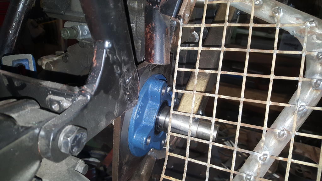

Stigian 1,235 #45 Posted November 3, 2017 On 29/10/2017 at 1:35 PM, Sarge said: I'm interested in seeing what this thing weighs when it's done - might want to upgrade the brakes....? Sarge Hey Sarge, weight wise it's going to be rather heavy, though the total weight will always be a guess as I have no way to weigh it.. The brakes have a had a bit of an upgrade, it did have drums on the front and an inbuilt brake on the rear swing arm... Now it's got discs on all four corners While waiting for the bearings to turn up, I thought I'd make a start on a sleeve to fit over the input shaft on the TB.. Not the best photo (I will get a better one) but here's the shaft in question. The only bit of steel bar I have which is long enough is made from very hard steel and looks like it has been used to hold a JCB bucket on... That sort of hardness! Anyway, I can make it in two parts and weld them together which would make it easier turning the tapered part half way down the shaft inside.. These two lumps I made years ago as pivot points for a dozer blade that was going to go on the 6x6.. A lot of turning to get them down to size! At least one is mostly done Woo Hoo... The bearings arrived Here's the TB to front end bearing mocked in place.. Best start getting the bearings mounted then.. First up something to bolt them to.. Well, a couple of somethings.. Bolted on. The black bit of steel across the lower bearing bolts is just to keep the bearing square to each other. You can just see where I welded on some tempoary bracing to the drive shaft to stop anything moving about withough the axle stand and other bits that were holding the bearings etc in place. If you flip the bearings over you can see the captive nuts that have been welded on... Don't think they are going anywhere Now the fun bit.. Making four somethings to bridge the gap between the back of the bearings and the chassis/frame.. Starting with a bit of CAD (cardboard aided design) work.. Which goes somewhere here.. Rather hard to hold it in place and take a farto at the same time! Roughly cut out of steel.. That looks better. Four of em made and tacked in place.. Bearings off.. Fully welded up... Almost.. It will be easier to weld the extreme top on bottoms where the brackets fit on the frame without the engine in and sump guard in place, so that can wait until stripdown time. Welds ground down, a nice curve at the back to clear the engine. And most importantly, there is still plenty of UJ clearance here.. And here And to finish off this update, a photo of the bearings etc quickly bolted on for this very photo.. The mounts were still very hot from welding and grinding so I didn't want the bearings sitting getting hot for too long.. 1 Share this post Link to post Share on other sites

Sarge 3,470 #47 Posted November 4, 2017 Yup - used CAD last night to make a baffle to seal the lawn vac to the deck on the 16 Auto - works great . I like how you set up those bearings to the drive axles - nice to keep them out in the open and easily accessible as well as not building up mud to rot it out . Sarge 1 Share this post Link to post Share on other sites
Stigian 1,235 #48 Posted November 8, 2017 On 03/11/2017 at 8:26 PM, elcamino/wheelhorse said: Cardboard Aided Design " excellent " , I always wondered what CAD stood for. Well now you know Jim On 04/11/2017 at 3:28 PM, Sarge said: Yup - used CAD last night to make a baffle to seal the lawn vac to the deck on the 16 Auto - works great . I like how you set up those bearings to the drive axles - nice to keep them out in the open and easily accessible as well as not building up mud to rot it out . Sarge Thanks Sarge, along the side of the engine was the only space I could put the bearings and shafts, but as you say they are easy to get at and shouldn't collect too much muck and mud... I will make a cover for the shafts and bearings as I don't want it grabbing a trouser leg and pulling me in! Not much to report, Monday was spent arguing with a car radio, and yesterday my knees were so bad I was only in the workshop for a little while.. But I did manage to get the front driveshaft welded up.. I don't think the welds are going to break Here's the latest MadTrax video... Enjoy 3 Share this post Link to post Share on other sites
Stigian 1,235 #49 Posted January 6, 2018 Hi guy's n Girls, long time no update.. So here's a bit of a big one for you.. Starting with a mistake on my part which was spotted buy Doug on MOM.. On 08/11/2017 at 10:50 AM, ranger said: "Great workmanship and thought going into this project Ian, grand job. I hate to say this but, in the photo of your driveshaft, it looks like the shaft yokes are out of phase. All shafts I've had dealings with, (apart from steering shafts installed at high angles, which don't spin at high speed), always have the shaft inner yokes in line to aid in cancelling out vibrations, not a problem if the whole assembly runs in a dead straight line, but when angles are involved? Not a criticism , just an observation . You don't want that coming adrift at any speed close to your leg The ideal perhaps, would be a pair of CV joints, if there's room." Well spotted Doug, I had an idea that the yokes both should be in a certain position but wasn't sure which.. Guess I should of googled it first! At least I had a 50/50 chance of getting it right The shaft also had a slight length problem as something had moved during welding, so in the vice the shaft went to have a weld cut down. Welded back up at the right length with the UJ's in phase The shaft out the TB is way too hard to drill, so the UJ is held on with a couple of grub screws.. I will add a couple more for peace of mind.. The UJ's that fit on the shaft with bearings are a very tight fit on the shaft, so I drilled them out to fit some nice tight roll pins.. The bolts are only there at the mo to make it easier to take things apart (many times) during building and will be replaced with roll pins. One of the UJ's being a MAN steering coloum UJ is normally held onto a shaft with a nut and bolt one side.. Fine if it's being used for steering but as it will be turning a lot faster it would of been out of balance! My solution was to cut most of the clamping bit off but leave enough to get a bolt through and clamp it tightly. (The drill bit is only there to line the holes up for putting a roll pin through) Part welded up.. A little at a time as I didn't want to fry the UJ. The bolt head and tread were cut off before more welding, then some shaping.. Still a little more to take off.. Oh, and I found a rather nice if rusty steel bar buried in the workshop, I guess I will be re-making the TB input shaft sleeve, but this time out of one piece.. It's a good job I have just got some more cutting tips and cooling fluid for the lathe With all the front drive train bolted back on the foot rest thingy needed a little trim to clear a UJ.. I will add a cover over the shafts/UJ's to add some leg protection should something go bang and start flapping about the place. Before I started to cut any more metal out I put some strength back in with a nice bit of curved tube that clears the UJ When the frame is stripped back down I will add some extra metal to tie the tubes together neatly. This join between old and new tubes just had to go! Hhmmm, nice rust inside one of the few remaining bits of the original FourTrax frame... It felt good to remove it There is no neat way of joining big and little tube together, at least the other end is easy For extra strength a length of steel bar has been added inside, you can just about see it where the tubes join.. The steel bar does go all the way up and in the larger tube. I like getting good value for money, think I might of got the maximum use out of this cutting disc Compair it to a new disc!! While on the subject, some cheap cutting discs are better than others, I can't remember the make (Germany is mentioned on the Fleabay ad) but they are by far the fastest wearing most easily broken disc's I have ever bought! That looks better.. Way better than the bit I removed Now the fun part, getting drive from the Honda bike gearbox which points towards the back, out the left side of the frame. A thank you to Nigel at this point for getting a shaft, pulley and UJ off the remains of a Kubota flail mower before it went off for scrap... It really was that rotten! The UJ in question, heavy duty and with no play in the bearings at all One side of the UJ is easy to attach as I have the shaft and roll pin that came out of it.. The other end has or (should I say had) some rather large splines! I'd be lost without a lathe, taking the OD down to size before cutting it off. Boring the ID out, a couple of arty flying cooling fluid shots The finished sleeve, yes it was turned down from a lump of steel the same shape and size it's standing on! UJ, shaft and sleeve.. A nice tight fit.. The sleeve has now been welded into the end of the UJ, yet another roll pin will hold it all together. Starting at the back, or is it the front!... Er.. Back of engine we have a UJ with splines in one end to slide over the output shaft on the bike gearbox. A shaft then goes through another bearing and into the Kubota UJ.. And comes out through the left side of the frame and another bearing. A chain and a couple of sprockets will give me drive into the transfer box As you can see I have some metalwork to do to hold everything in the right place.. Space is tight but shafts and UJ's turn as the should without hitting anything or feeling "notchy" which proves the concept of it will all work And onwards with the story, another slight change of plan coming up shortly.. The outter bearing needs something strong to bolt on to, so I dug out a bit of 8mm plate and set to on the lathe. It will fit somewhere here, to make life more interesting the plate needs to be removable or I won't be able to get the transfer box back out the frame! Before I started on the mountings I thought it would be wise to tidy up this bit of frame first. Mostly chopped out.. That looks better. Plate and bearing set back in the frame a tad, it fit's rather well.. Plenty of UJ clearance by the transfer box. Before I can start mounting the plate I need to make sure both shafts are parallel to each other.. Here's the jig thingy I make to keep the shafts parallel. It doesn't lok that much but both the tubes are a nice snuff fit on the shafts they have to fit on. A lot of time was spent making sure both tubes are parallel to each other.. Trim, measure, trim, measure, trim, measure.. Weld measure, weld a bit more, measure.. You get the picture. Fitted.. The shafts are now parallel to each so I can start working out how to mount the bearing plate. Out of interest I put the foot rest/guard thingy on to check it still fitted... Not bad, I will only have to loose a small amount of foot space to fit a sprocket with guard of course. It was roughly at this point that a couple of comments left on Farcebook had me thinking about how safe the right turn UJ set-up actually would be.. Tight UJ angles and high spinning speeds are not the best mix! Sooooooo..... I started on the exhaust instead Share this post Link to post Share on other sites
Stigian 1,235 #50 Posted January 6, 2018 There was no way the exhaust system I had built would fit back on with a transfer box and a dive shaft in the way, the only part that fits is the big bore pipe that runs down the side of the engine through the frame! So a bit of a re-make is needed, I started at the front after slicing off the bits that fit into the engine.. The only tube I have enoug of is a bit bigger than I had been using, so how to go from something small to the bigger blue bit size! Find a bit of tube that's slightly bigger than the small bit but slightly smaller than the big blue bit and make four long-ish cuts in it. A hose clip squeezes it down to size. Welded on and extra tube trimmed off. Welds cleaned back. A bit of hammer work soon had the other end a bit wider. Welded on to the big bore pipe. Lot's of careful welding later had the gaps filled up. Test fitted to the engine, one side cleaned up. Oh... the slight change of plan... With the UJ's etc removed I found there is just enough space to fit this er... final drive? 90'd drive thingy from the very same Honda Silverwing that gave it's engine up for Why Not all those years ago! I will need to fit a chain n sprocket to get the power from the bike gearbox into the 90'd drive thingy which has a 5 to 1 ratio (I can "gear" that ratio out), and yes it will spin the right way And to finish off a couple of photos of the unit I had taken to put it on Fleabay.. Quite glad I didn't get around to listing it Having short stubby pipes sticking out the engine I needed to make them a bit longer and join together. The first bend, Im going for a more agricultrual look with the exhaust system to make it stand out a bit from the swoops of the frame, so lots of pie cuts going on. Plenty of penetration which is good to see The N/S pipe almost done. The long bit that goes across the frame was welded in place first the couple of bits of box were there just to keep it in the right place, below the radiator.. The rest was made up to fill the gap. Before doing the O/S pipe I needed to know how it was all going to fit into the main pipe which runs along the side of the engine.. Sooooo, how to fit two of the smaller pipe into the bigger one!! Some measuring and cutting later.. The pipes are over length as I knew I'd need to trim them just not quite sure where yet. Welded up and slotted in place. And joined to the N/S pipe.. Before you ask.. Yes the welding rubbish was cleaned from the inside of the pipe sticking out the engine before anything else was welded to it.. These CX/GL 500 Honda engines only run at their best if both cylinder/header pipes are the same length each side... The N/S pipe came in at 30 1/2 inches, so I had to try and fit that length into a rather small space on the O/S and still have good gas flow!! A long bit of pipe with lots of pie cuts marked out.. Can you see where I'm going with this? A shorter bit of pipe.. Lot's of hollow metal pies.. And lots of blue power coating on my bench from cleaning the pies.. This bit of cardboard was used to work out some angles to cut, the metal version will fit about here. So I didn't end up welding up a bit hollow Polo mint I added a bit more cardboard to the mix. As long as the loop follows the spiral it should not end up hitting it's self A bit of lunch and lot's of welding later the result is some what curvy Some bit's could not be welded in situ so to make sure nothing could move during welding I added a couple of braces before taking the exhaust off. Fully welded up, just a lot of welds to grind down.. Funky shape eh? With the exhaust bolted back on.. I could start on the next part of the puzzle, the rear exhaust section.. It's going to be interesting trying to join these cans.. To the bit of big bore pipe you can see below the tank in the triangular bit of frame.. As someone has put a transfer box right in the way and there isn't really enough space between the TB linkage arms and the frame.. Yep, it's going to be interesting for sure The solution to joing the two bit's of pipe together was this ear trumpet shaped bit of pipe. It's a tight fit around the transfer box, a very thick ally heat shield will be going between the exhaust and the black electrical gizmo with the word up, upside down.. Don't want to melt it! Apart from grinding down lot's of welds that's the exhaust system done Next on the hit list to sort is the shifter for the transfer box.. It needs to go somewhere around here, also the bracket looks really ugly so a new one is being made.. The fun bit is going to be making the rods that connect it to the transfer box, but luck might be on my side as I found an easy route through the frame, above the carbs that will require minimal bends to the rods.. Oh, a scrap pile raid produced all the rods I could need 1 Share this post Link to post Share on other sites
