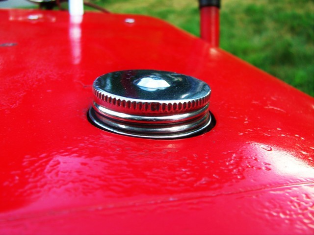

russellmc301 601 #70 Posted July 17, 2016 (edited) tank is all cleaned and ready for paint the hood it good on the outside but still has some spots on inside. after the hood is done we will clean the engine and then paint it. the muffler pipe wouldn't come off so we will have to paint it on the engine.then get all the little odds and ends gathered then the wheels. hope to have it done soon. what is the gas cap subpose to look like? mine has some welding on it. Edited July 17, 2016 by russellmc301 Share this post Link to post Share on other sites
russellmc301 601 #71 Posted July 19, 2016 got the hood dings and cracks filled in and sanded the serial plate and it looks great so i don't think i will use the decal. also soldered the cap then used filler to make the cap smooth, then put some gasket material in to seal it. is the cap suppost to have a hole? Share this post Link to post Share on other sites
russellmc301 601 #73 Posted July 19, 2016 alright do you have a picture so i can make a hole in mine? Share this post Link to post Share on other sites

AMC RULES 37,260 #75 Posted July 21, 2016 (edited) Edited July 21, 2016 by AMC RULES Share this post Link to post Share on other sites
