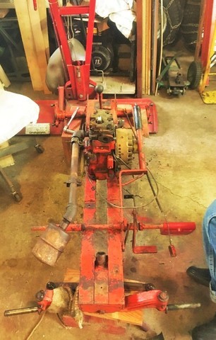

russellmc301 600 #1 Posted June 3, 2016 As some know i was asking about a fair price on a 400 suburban and i the doctor gave me my medicine for over the summer. So i picked it up a couple of weeks ago and now is is siting in the garage ready for the pro restoration. rusty was the first restoration but this one we are going to go show worthy. i have wanted a suburban forever so now is the chance to do it right. pictures are coming but it we haven't done much yet besides taking the deck off. 5 Share this post Link to post Share on other sites

russellmc301 600 #4 Posted June 3, 2016 (edited) well i figured i ought to get it so i did their she is geting a bath, once we got done we put her in the yard to get some fresh grass and dry some. Edited June 3, 2016 by russellmc301 10 Share this post Link to post Share on other sites

russellmc301 600 #6 Posted June 5, 2016 she is all ready to start geting painted. how do i roatate it on here to make it be the right way? what is the best primer to use? 1 Share this post Link to post Share on other sites
