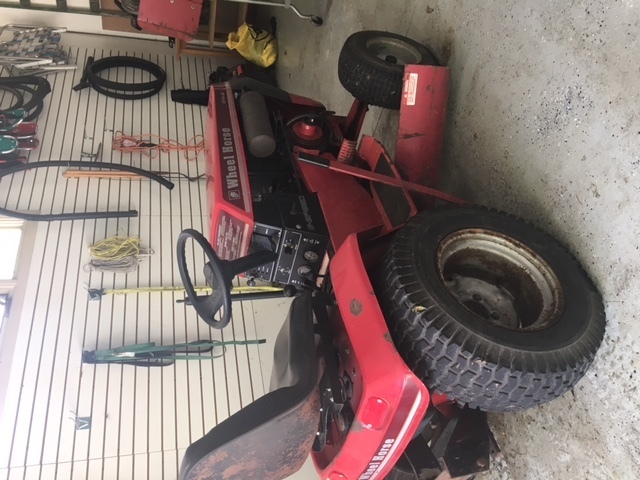

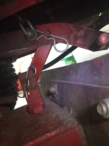

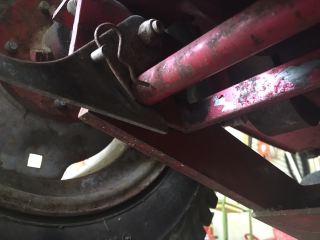

gmcarlmrnet 16 #9 Posted May 29, 2016 Have spent the last few hours putzing with the tractor. Instead of taking off the mower from the carrier to test the pto I thought I would try hitching up the snowblower. Thought I could have the belly grader on at the same time but apparently not. I don't want to wear out my welcome on my first day but could somebody explain how to unhitch the belly blade correctly. I think I have figured out the back. The first two pictures show that. just undo the cotter pin and rotate the u shaped holders and the back bar falls out and the whole back falls down as a unit. The last picture orientation--the blade is on the front/bottom. Their are two cotter pins holding the front of the unit on. Either one will separate the blade from the tractor but not sure what has to be left on for the mower deck or snowblower. Thanks 1 Share this post Link to post Share on other sites
can whlvr 994 #10 Posted May 29, 2016 take off the bar from the mower lift arm,this is the lift bar bar for the blade,and ondo the rear levers till the blade falls out of the rear bracket,leave the rear hitch on,it wont be in the way of anything,the mower lift bar stays for mowing of coarse or you wouldn't be able to lift the deck,i take that off for snow thrower and plow,but it can be wired up out of the way,as the thrower uses a different arm on the bell crank as the mower or grader blade,its very simple to remove the grader,and you cant ask too many questions,thats why theres thousands of members 2 Share this post Link to post Share on other sites

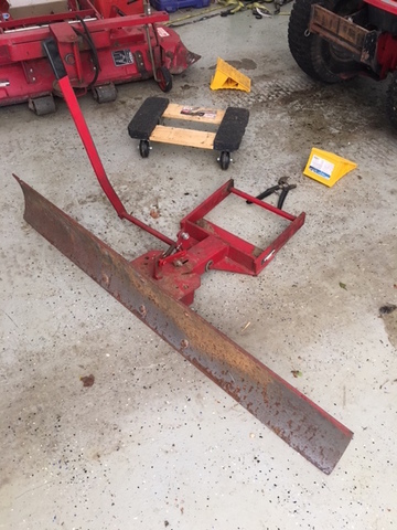

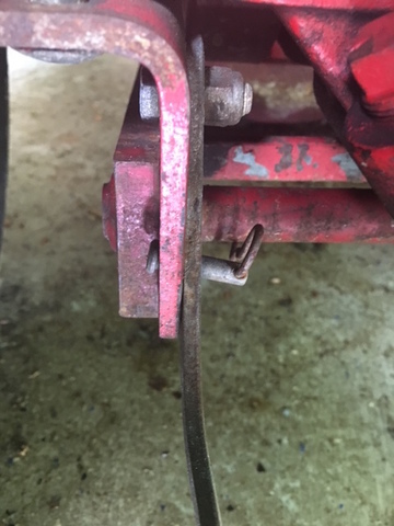

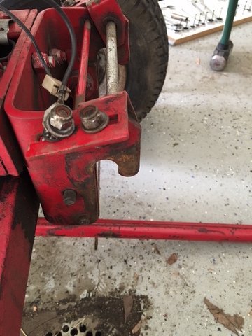

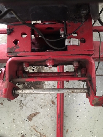

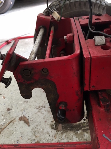

gmcarlmrnet 16 #12 Posted May 30, 2016 Thanks can whlvr. Blade off and I am including picture. As a newbie I didn't understand what was part of the tractor and what was part of the blade. A few surprises yesterday. Attached the snowblower and it seemed to cant to the right (view from sitting in the drivers seat) at the attach a magic hitch. Pictures included. It is bent a little where the hitch attaches to the tractor. more importantly the U-shaped holder on the left side (that holds the horizontal shaft from the snowblower attach) is bent open some. On the left it measures 21 mm and on the right 16 mm so it doesn't fit snugly and the snowblower rotates to the right as it "opens". I gently took my hammer to it but didn't seem to budge it though I wasn't very aggressive. I don't know a lot about metal/fatigue or how to fix this. Don't have welding or heating up skills. Could take it to a shop or a new one is about $50+, or do I just get more aggressive with my big mallet hammer. Any suggestions? Lastly, the other two pictures are of a piece that came with that I don't really know what it does or where it goes? Possibly part of the mower connection? Thanks for any help. Gary Share this post Link to post Share on other sites
wallfish 20,733 #13 Posted May 30, 2016 It's probably easiest to remove that front Tach A Matic and use a hammer with some force to make it straight and square again. The connection link in the pics looks like a solid lift link for a snow/dozer blade. It allows you to apply down force to the blade by pushing on the lift handle. 1 Share this post Link to post Share on other sites

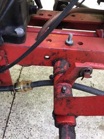

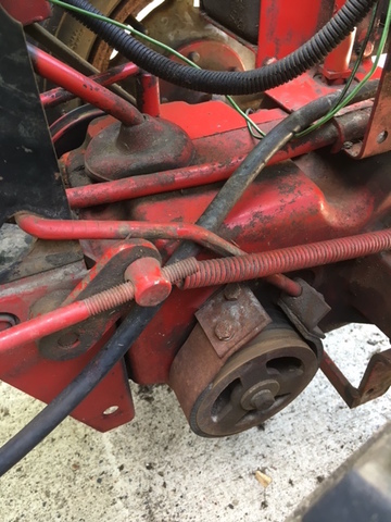

gmcarlmrnet 16 #14 Posted June 12, 2016 Took a hammer to it but I could not get it to bend despite some pretty hard slugs so bought a used one on eBay for $20. I suspect if I could have heated it I could have bent it back. Today I took off the seat and other pieces to look at the innards and clean it out. I have two small issues 1) the fuel line path doesn't seem right to me. It crosses under the brake bar and gets pinched a little when I set the parking brake (first picture) and then sags under and is tied to the clutch bar with a zip tie. You can see an inline filter in--not sure that is supposed to be there but probably not doing any damage. As I look at it seems like it should go thru the gear shift box out the hole then proceed forward to the engine. 2) I was adjusting the brake as they recommended but if I tighten it to make it so the tires don't turn when the parking break on the brake rubs when it is off. If I loosen it so not rubbing with the parking break on I can push the tractor (just rubs). I suspect the brake pads are a little out of round/old and will probably just have to keep it loose. Have enjoyed seeing how things work. Next order of business is to focus on the carb. Gary 1 Share this post Link to post Share on other sites
can whlvr 994 #15 Posted June 12, 2016 that is not how the fuel line runs,if you take the cover off where the gear shift goes through,you will see a hole that passes through the hood stand,under the battery and then goes left to the carb,you might need a new brake shoe,the brakes arnt as good as they could be,they do work but don't compare them to automotive brakes 1 Share this post Link to post Share on other sites

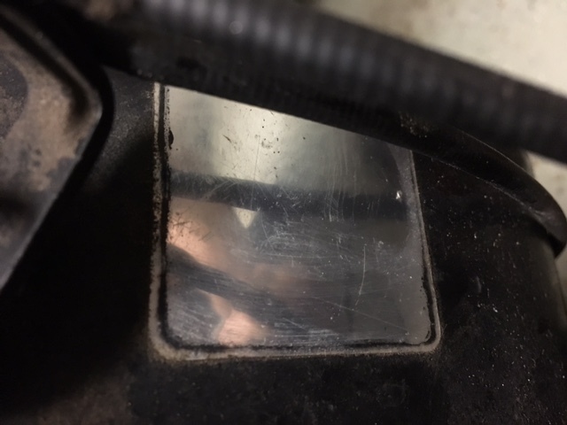

gmcarlmrnet 16 #18 Posted June 13, 2016 Really appreciate the help but here is a picture of my data decal on my motor shroud. It is completely blank--as if somebody polished the tag.This tag was right below my carb on the engine shroud so I think I am looking in the right place. Do I have any other options to find out what motor I have? Gary Share this post Link to post Share on other sites
608KEB 854 #19 Posted June 13, 2016 (edited) I'd put the front attachamatic in a press Edited June 14, 2016 by 608KEB 1 Share this post Link to post Share on other sites
