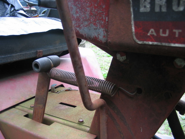

daveoman1966
The linkage develops slop and wear after 30+ years.....whodathunkit.  Here is what I did to eliminate the rattle on my similar Bronco 14.

Yes i wasnt sure if that was a problem or not. The old belt would push agaist the pully enough to make the tractor move at full speed while disengaged.  Now it wont move at all in disengage mode. So i guess thas a good thing. Thanks. Also the lever shakes and rattles like crazy. Is there an adjustment for that or is it normal?
I take mine to a friend who cuts off the worn pivot pin and welds on a new one then he welds shut the worn pivot hole and drills a new one.
