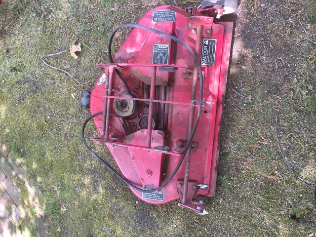

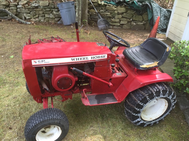

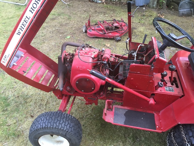

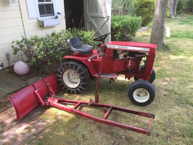

I just picked up a c81 with a mower deck and plow for $300..not sure if it runs but looks good.  I washed it up and 1st step is a battery...any suggestions on how I should proceed or what to look for?  Or if it was worth $300?

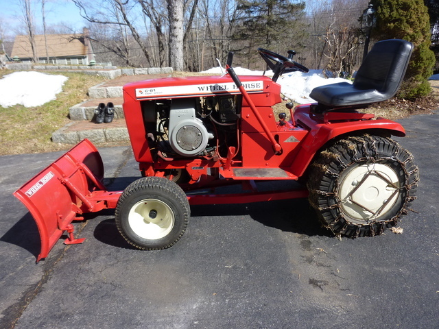

Think you did GREAT C81 my favorite tractor....not so much for the mower... but it is a bear for pushing snow and doing chores around the property, good fuel, clean carb and a good set of points and you will have one (in my opinion) one of the best machines made.

North. :WRS:  Looks good in picks. Get a battery from Walmart or Home Depot same price. just to see if you have spark. Then maybe change the fuel lines and filter. Buy good fuel line $3.00 to $4.00 a foot, start it  and see where you are at. Let us know how things are.

That looks like an outstanding deal. As already suggested I would do a tune up, fuel lines and filter, fresh fuel, engine oil, flush transmission and fresh oil.:)

As others have said, good buy. plow and chains are worth half that, and....  :WRS:

I'd say you gotta a sweet deal on your horse!  She's definitely worth putting a few $ in to get her going.  Looks complete except for air filter and cover.  And you'll need a couple of mower deck wheels.
With a little diagnosis you should have her runnin' in no time.  After you get a battery hooked up, check for spark and compression.  Then go through the fuel system.  I don't know how long it's been setting, but I would check the shutoff valve in the bottom of the fuel tank for rust and crud before putting any gas through it.

Fresh fluids and a new battery!  Onto the mower deck
