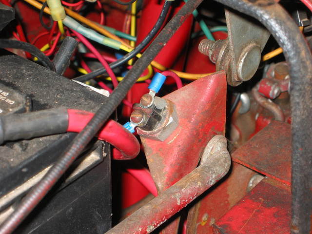

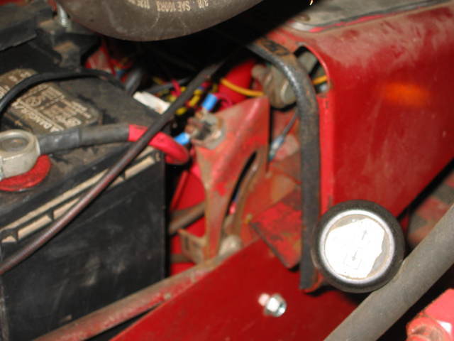

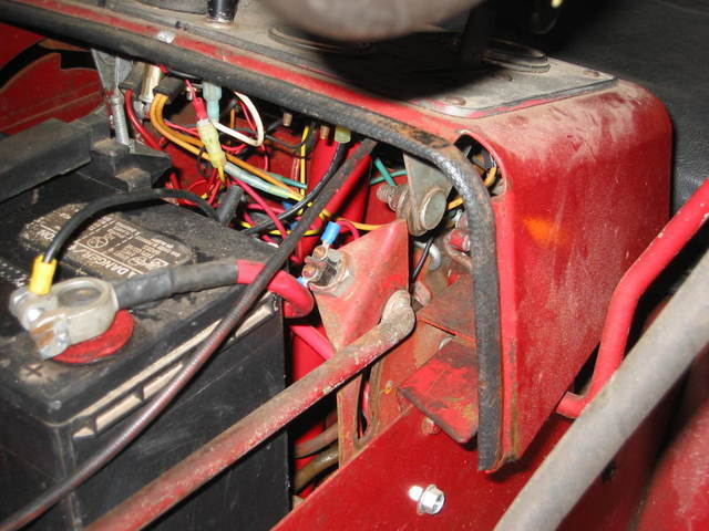

pfrederi 21,306 #5 Posted May 23, 2016 There is a safety switch related tot eh PTO lever on the left side it will not let the engine crank or fire if it the PTO is not disengaged. The pump for the loader usually is run off the PTO so the PTO lever would have had to be functional for the loader to work. Look for a button type safety switch on against the PTO linkage under the hood near the dash panel. Fuel pump was originally a pulse job...many failed and electric is a good cheap replacement 2 Share this post Link to post Share on other sites

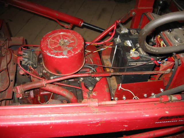

pfrederi 21,306 #6 Posted May 23, 2016 Pictures of PTO safety switch First 2 show PTO off. Switch is depressed tractor should start. Third picture (blurry) PTO engaged switch not depressed will not start Last pic shows whole PTO arm.. 3 Share this post Link to post Share on other sites
pacer 3,181 #7 Posted May 23, 2016 As others said "you stole it!" Geez, that is a nice looking tractor! (course I'm a bit partial to the "big D's" I have 4 of them...) As mentioned check for a safety switch problem, If in doubt on one, just temporarily jumper it. Rig up a test light or meter to the coil and start wiggling wires etc. Obviously the seat switch needs to be checked since there isnt a seat! Dont be surprised if the switches are already jumpered, they can be such a pain - Ive bypassed all of mine or rermoved them My first thought on spark fire is an all too familiar thing that happens to points after sitting for an extended time, they will get a "glaze" on them. Solution is simple, get a small piece fine grit sand paper, fold it and drag it through the points rubbing off the glaze. And fortunately the points are easily accessible on your engine just under the air cleaner. Electric fuel pumps are a very good thing to have, I have one on all my D's. Now, the biggie - the transmission! That could be a real problem, the Sundstrands (and the steering) are the biggest problem with the D's and I really dont have any pointers on them (all mine work very well) Hopefully after you get it running we can tell more about it... Again, really nice looking tractor! 3 Share this post Link to post Share on other sites

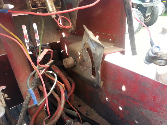

BMW1 44 #8 Posted May 24, 2016 pfrederi, this is all that is left of the PTO linkage Share this post Link to post Share on other sites

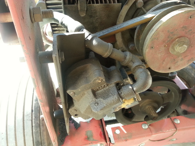

BMW1 44 #9 Posted May 24, 2016 pfrederi, This is a picture of the pump for the loader. Previous owner removed grille to make room for it. I just realized the muffler must be missing from that side. Isn't that right where the muffler should be for that side? That would explain the pipe I saw connecting the two exhaust manifolds and then to the muffler on the other side but was in a hurry and forgot about it. Is it common to mount pump like that? Seems like there should be a better way to do it? I knew it would be work when I got it. I don't mind, my son and I will get to learn all kinds of new things and we will learn patience!! 2 Share this post Link to post Share on other sites
pfrederi 21,306 #10 Posted May 24, 2016 Sent you some pic by PM. Never saw a mount like that. The pulley he is using is really for the Rear PTO. Most loader pumps run off the front sheeve. Share this post Link to post Share on other sites
