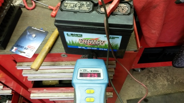

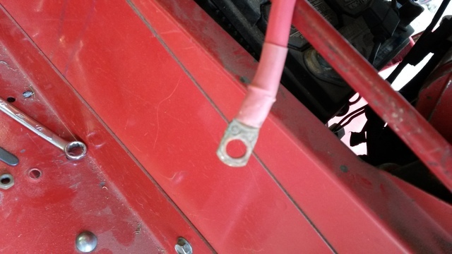

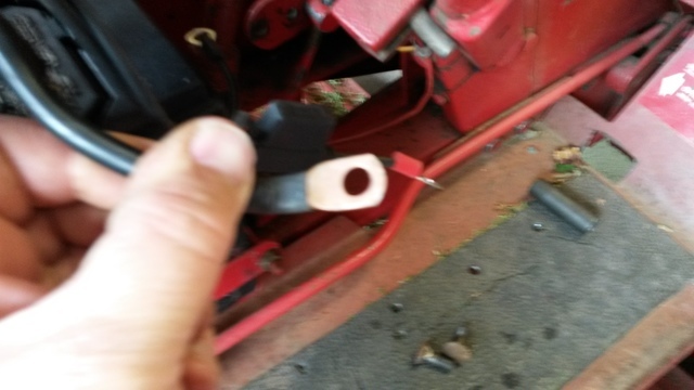

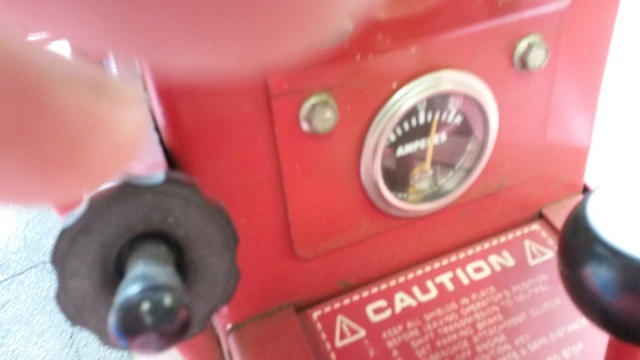

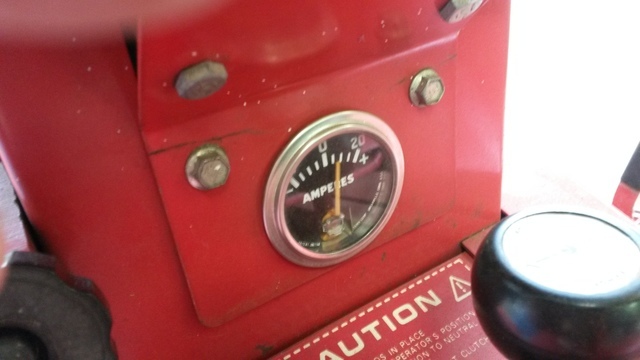

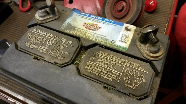

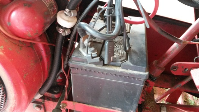

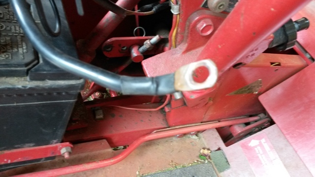

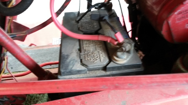

squonk 48,141 #1 Posted May 21, 2016 We've all seen the posts. "My tractor only clicks" Ammeter read discharge ect. Many times it's just a little dirt behind the ears and between the toes. Here's what happened to me today during my latest mowing session with EZRA. As I was finishing up I happened to look down at the ammeter. It was slightly discharging. didn't have time to work on it right away but later I started it up and the ammeter stayed on the discharge side. So I shut it off and got my trusty Chrysler 1986 Gold Tool Award multimeter out and checked the voltage of the battery. It read 12.5 V . Started it back up and had 14.7V. Looked at the ammeter again and now it's charging. All I did was probe the battery cables and the problem is gone. Let's look at the battery. Typical Garden Tractor variety dirt on the battery. Battery will come out for cleaning. Terminals show a slight bit of corrosion. Cleaned up the cables and cleaned the battery. You can see the battery cleaner working by the purple color. Testing the battery. This is 2 1/2 years old. 375 cranking amp battery still shows 375 Amps. all back together and still shows recharge after starting on the ammeter. 6 Share this post Link to post Share on other sites
Digger 66 3,530 #2 Posted May 21, 2016 Good post ! I see you have the pigtail hardwired for the Tender Jr too ( just like all my toyz ) Pressure washers can also wreak havoc on electrical connections too . Not so much on the exposed terminals & such but where the water can sit & slowly chew away at the copper . A Google search will reveal the effects of chlorine on copper . 1 Share this post Link to post Share on other sites
