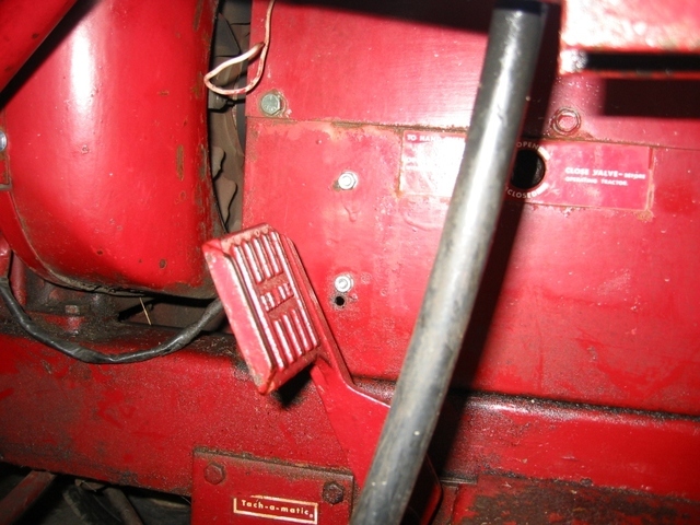

that's a bolt usually on the left side when your sitting on it. There is a hole through the side to the side of the hydro unit. Its usually a square head bolt. Tighten it gently to make the hydro engage.
pfrederi
Some have a slot head you turn with a big screw driver
  • Like 1
pacer
BUT!! --- dont be surprised if the dang thing is STUCK! :-o
