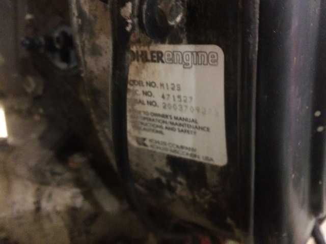

gwest_ca-(File Mod) 11,990 #2 Posted May 19, 2016 These diagrams cover 1990-1991. If you have a different year don't use them. The 471527 spec was used 1987-1997 and the engine was made in 1990. Garry Share this post Link to post Share on other sites
