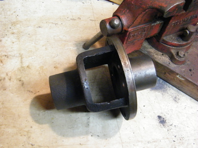

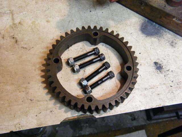

stevasaurus 23,861 #6 Posted May 19, 2016 Hello MXMW...Welcome to Red Square. Welding new teeth on the mushroom gear is an option. We have a few machinist members here that could do that, but I don't know if anyone has done that yet. It is still fairly easy to find parts. About your differential bull gear. Is the gear the bolt on type or is the differential and gear one piece?? This is the one piece. I am having issues trying to load pictures for some reason. The WH# 1257 is now TORO #83-2840...they are the same and the right ones. Here is the 2 piece.. 2 Share this post Link to post Share on other sites

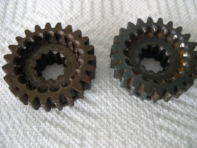

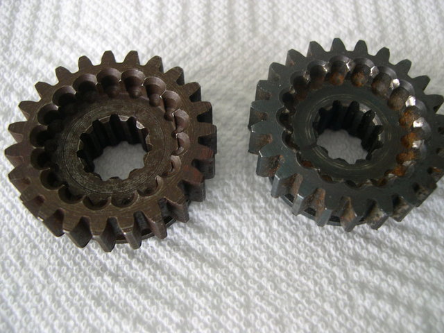

Racinbob 13,250 #13 Posted June 14, 2016 Can you post another shot of the internal teeth on the 3523 gear. It's hard to really tell from that picture. Here's an angle that shows it better. The gear on the left is NOS and the right is worn but should be serviceable as long as you're getting a full engagement of the two gears in 3rd. PM sent 1 Share this post Link to post Share on other sites
midxmidwest 8 #14 Posted June 14, 2016 here is my( high gear) ? hard to get a good picture,the wear looks to be somewhere in between your gears. I bet good ones are hard to come by. 1 Share this post Link to post Share on other sites
Racinbob 13,250 #15 Posted June 14, 2016 Hard to find is an understatement. I found that NOS on Ebay. That's a much better picture. I think you'll be fine with that one and your input gear is decent. I agree with Steve on how good everything looks considering the damage to the two gears. You're doing a great job on it. I'll be in touch tomorrow. 1 Share this post Link to post Share on other sites
