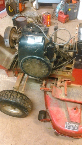

grine_22 145 #1 Posted May 11, 2016 So I recently acquired a nice 310-8. The grandpa-in-law said the carb was acting up. Got it home, adjusted and it will idle just fine, I throttle up and take off and it will intermittently start stalling or backfire. But if I throttle back down to idle it runs OK. Switched out coil condensor and plug as well. Next step is the carb, either rebuild or find a new one. Any other ideas or advice welcome. Share this post Link to post Share on other sites

grine_22 145 #17 Posted May 17, 2016 (edited) OK question for the more knowledgeable around here, I tore into the motor and got to the valves, clearance for intake was good, but exhaust was down to .16, would .02 difference possibly cause backfiring and rough running beins the exhaust isn't opening enough to burn all the fuel going into the chamber? Edited May 17, 2016 by grine_22 Share this post Link to post Share on other sites
grine_22 145 #18 Posted May 18, 2016 Good news, adjusted the valves cleaned breather out new gaskets and she runs great. One question tho, I didn't put the hood back on for a test run in case, I noticed the muffler got cherry red, I know they get warm but that warm? Share this post Link to post Share on other sites
