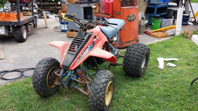

Over my summer vacation last year I got a four wheeler from my cousin in return for working for him during the summer. The four wheeler did not run and it was (and still is) in rough shape. It started out life as a Suzuki Quadsport 230 until someone ripped the motor out and put in the motor from a 1983 Yamaha XT200 on/off road bike. These people obviously had no idea what they were doing as you will see in future posts to come. I find this absolutely hilarious how chopped this thing is.

So when I first saw it I thought "New plastics, seat, paint job and it'll be awesome" That's not the case at all actually. Things only get worse from here. (I will have to go take some better pictures for you guys)

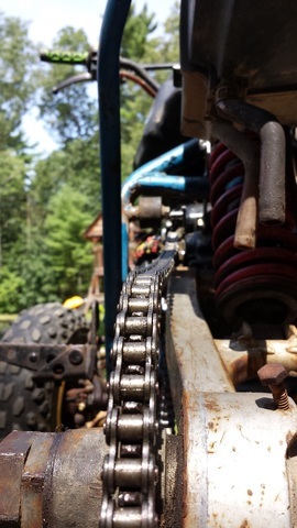

So I finally get it home and I immediately change the plug and clean the carb. I put it all back together and put some gas in 'er and go to kick it over, (that's right no electric start) and i find that you cant kick it all the way because your foot hits the back tire so I put a chain on it and tow it up to the top of the drive way and hop on, throw 'er in second and pop the clutch. It starts up but sputters and dies. I mess around with the carb adjustments and try it again, and it fires right up running strong. "this is awesome everything is going great!" I shift down to first and slowly let out the clutch and get going but the chain falls off. So I put it back on and try again. Same thing... "hmm whats going on?" I put the chain back on and pop the clutch to stall 'er ( that's the only way to shut it off cause none of the switches do anything...) I get off and look at the sprocket alignment and what I saw was insane.

Nathanielperz
Yeah the front sprocket was about 1" out of place so we cut the horrible engine mounts that were there and made some new ones welding it in solid. And it doesn't run anymore either lol
