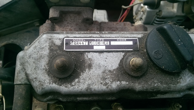

19richie66 17,893 #7 Posted May 7, 2016 (edited) They have 2 cylinder Kubotas if you look around. I can get you measurements off of a 3 cylinder tomorrow morning if you would like. We have one in our Club Car 4x4 service cart. So much power its unbelievable for a golf cart. Pulls like crazy. Fireman, that looks so cool. Bet it would be a hoot to drive. Edited May 7, 2016 by 19richie66 1 Share this post Link to post Share on other sites
