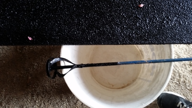

Shynon 7,728 #28 Posted May 6, 2016 11 hours ago, Fun Engineer said: That looks good Tom. Did you have to use the narrow roller they provide or did you use something else? Seems like that would take forever. And were you able to adjust the amount of texture via the roller or is it just one texture? I appreciate everyone's thoughts and opinions. Dave Dave If I remember correctly I used the roller they supplied(2 per gallon) because the roller is a foam plastic and I was worried about other rollers falling apart or sticking in the coating. I bought some cheap paint brushes for the seams around the edge. You really can't adjust the texture, There are larger chunks in it. The first coat goes on very light, you can see the substrate, but will have some large chunks in. The second coat is the one that covers all, they have to be done with a certain amount of time in between. I think I did mine over 2 days right after I brought the trailer home. 1 Share this post Link to post Share on other sites

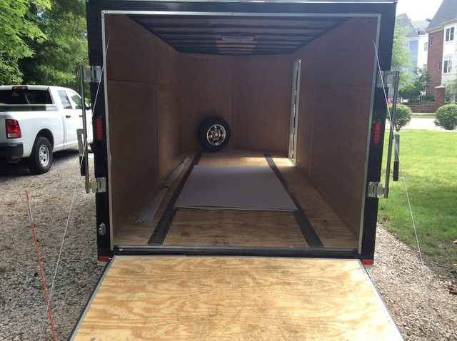

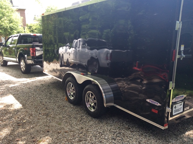

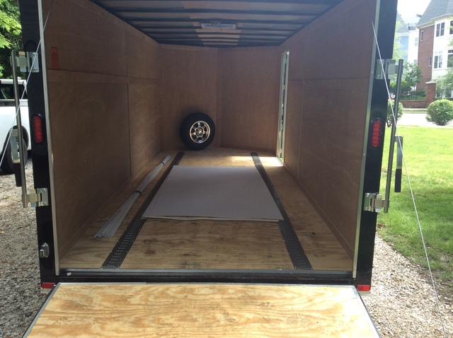

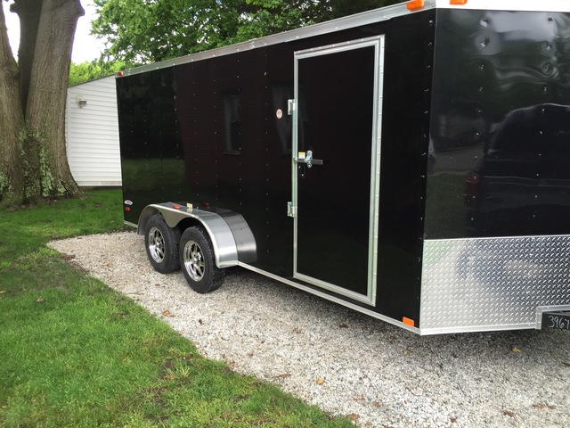

limited12 360 #32 Posted May 7, 2016 Picked up the trailer today, I think I'm going to go with the herculiner, I went ahead and got the ceiling material to in stall after I run some more lights, thinking I'm going to paint the walls white also. 5 Share this post Link to post Share on other sites
Racinbob 13,277 #33 Posted May 7, 2016 Nice trailer Tommy. I'm looking forward to seeing it when it's done. Share this post Link to post Share on other sites
Shynon 7,728 #34 Posted May 8, 2016 (edited) Tommy When I put my herculiner in I went and put it to the top of the bottom trim strip, thus sealing in the seam of the main floor. Also not sure if you are, but I put foam insulation in the ceiling, as I camp in mine I was hoping to quiet the rain. I installed my e-track about 5-6" from the edge, because I tie tractors down by the tires. Very nice looking trailer Edited May 8, 2016 by Shynon Share this post Link to post Share on other sites
WHX?? 58,347 #35 Posted May 8, 2016 Nice Tommy...just picked up mine yesterday too. Looks like you gto a matching spare too Share this post Link to post Share on other sites
limited12 360 #36 Posted May 8, 2016 10 hours ago, Shynon said: Tommy When I put my herculiner in I went and put it to the top of the bottom trim strip, thus sealing in the seam of the main floor. Also not sure if you are, but I put foam insulation in the ceiling, as I camp in mine I was hoping to quiet the rain. I installed my e-track about 5-6" from the edge, because I tie tractors down by the tires. Very nice looking trailer Thanks for the advice, I didn't think about the insulation, great ideal. The dealer had installed the etrack and he has 1' from the wall. Share this post Link to post Share on other sites

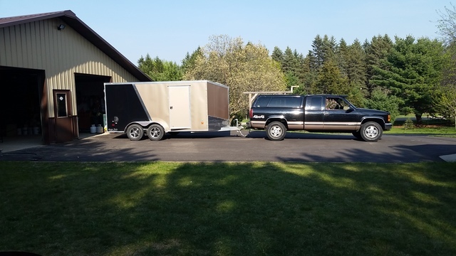

WHX?? 58,347 #37 Posted May 8, 2016 Here's a pic of mine. Picked up two gallon of Herculiner at Fleet Farm 65 a kit minus a 20 per kit rebate. Hope to get it down this week. Then a wheel chock in the front for the bike & some e track. 5 Share this post Link to post Share on other sites
limited12 360 #38 Posted May 8, 2016 Nice looking trailer Jim, what kind of wheel chock are you planing on using. Please let us see some pics when you are done 1 Share this post Link to post Share on other sites

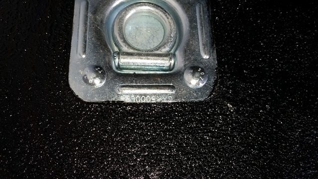

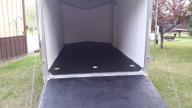

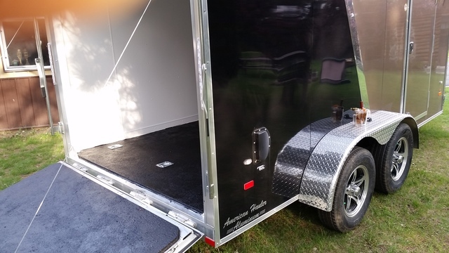

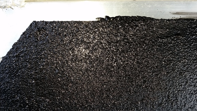

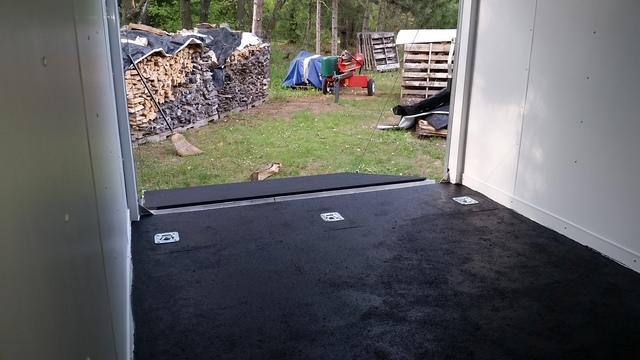

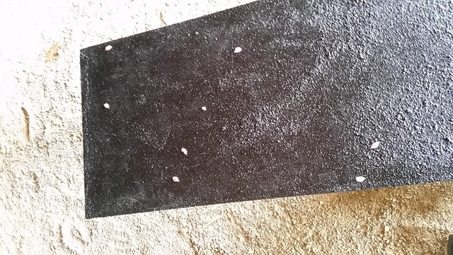

WHX?? 58,347 #40 Posted May 17, 2016 (edited) Ok so here is how it came out...same as Tom"s It is very rough and non skid so if you want a smooth surface this is not for you. You could dump a quart of oil on the floor and not be slippery so handling a 1000 lb motorcycle in it should not be a problem. No big problems with applying it either. Just make sure you wear gloves this stuff does not come off your hands. The book says two coats one right after the other and while the first coat is still tacky but because of time I had to wait a few days. Two coats is a must tho. I was going to lap up the side to the top of the bottom trim but it did not like to stick to the smooth surface of the trim. In fact it does not adere well to anything smooth. I got a little on the tailgate aluminum frame and it peeled right off. The wood floor, which was a smooth sanded osb/particle board, it is not coming off. Now on to some e-track and a bike chock more on that later. Took the loading flap off to do it separate so as to get under the hinge sealed. ..just don't do it under a crabapple that decides to start droping flowers! Also get a mixer and stir well and often with the drill. The non skid, which I believe is just ground up used tire rubber, likes to sink to the bottom. Ya get down to the end of a can and it gets quite thick ...almost like black jack roof tar. Edited May 17, 2016 by WHX61/3 4 Share this post Link to post Share on other sites
WHX?? 58,347 #41 Posted May 17, 2016 First coat does go on hard and used more. 2nd coat a breeze. The kit did have a roller with two rough coat sponges and a throw away brush but make sure you pick up a couple of extra brushes. Two gallon kits for a 7x14 and had about 1/4 of leftover... nuff to do some other stuff. It would work good on shovel handles or tractor running boards. 3 Share this post Link to post Share on other sites
Racinbob 13,277 #42 Posted May 17, 2016 Looks great Jim and very practical and functional. I like. 1 Share this post Link to post Share on other sites

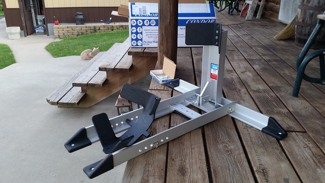

limited12 360 #44 Posted May 19, 2016 That looks good Jim, hope to do mine next week, seems like it rains everyday. i like the way the finish turned out 1000 lb motorcycle... Must have a ultra classic? i did go ahead and bought the condor wheel chock, little pricy but I like the way it locks in place and the quick connect hook up. 1 Share this post Link to post Share on other sites
WHX?? 58,347 #45 Posted May 19, 2016 You & me gonna get along real well Tommy....2011 limited, 103 motor, last bike I will ever buy cept for a trike when I can't stand up no more! Really bizarre you should mention the condor as that's what I got coming..pics to follow once is gets here... 200 off flea bay with another 25 for the trailer mount ...oh and free ship!!! Plus I can use it in the shop for the choppers. Was just thinking the 30 dollar cheap chock but then my bro who could help me build one says "you gonna put a 20k bike in a 30 dollar mount!" I say build me one yer the welder "got no time"...thanks bro gotta have it in five weeks. No can do....dogs pregnant.... Share this post Link to post Share on other sites

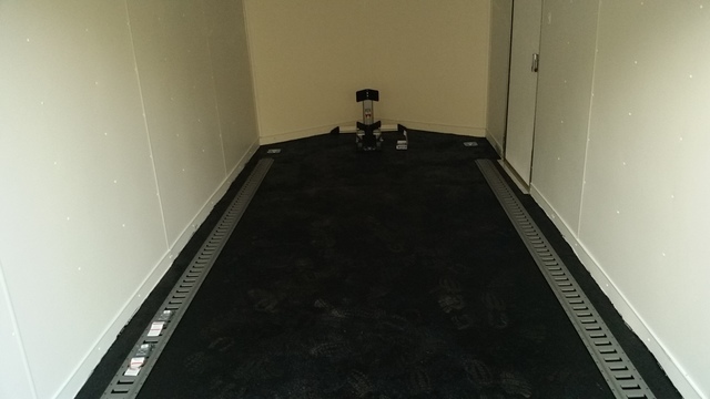

WHX?? 58,347 #50 Posted May 20, 2016 (edited) Chock came in yesterday - real nice surprise when I got home from work. Try it out tonite. Picked up a couple of 10' e track and get that down this weekend. Going to mount them more outboard than yours Tommy. I like the way Shynon ties his horses down. Edited May 20, 2016 by WHX61/3 1 Share this post Link to post Share on other sites
