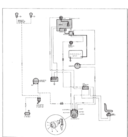

rmaynard 17,572 #13 Posted April 28, 2016 10 hours ago, LFR said: Yeah but it turns over so I don't think that's it! Because it just wouldn't turn over if it wasn't working would it? The starter circuit does not go through the seat switch, but the ignition does. Both do go through the PTO interlock switch. 1 Share this post Link to post Share on other sites

LFR 39 #16 Posted April 28, 2016 I won't do that! So in other words if I still don't have spark it could be the pot interlock switch? Cani bypass the pro interlock switch if I still don't get spark? Share this post Link to post Share on other sites
gwest_ca-(File Mod) 12,483 #17 Posted April 28, 2016 Do you have a test light or a voltmeter? Connect it to the coil (+) terminal and chassis ground. Turn key to RUN position and you should get 12 volts. Now turn to START and you should still have 12 volts while cranking. Connect tester to the coil (-) terminal and chassis ground. Turn key to RUN. When the points are open you should have 12 volts. When the points are closed you should have 0 volts. So if cranking the motor with pull rope or starter the above should happen. It may happen too fast to notice. Remove the spark plug and turn the motor over by hand using the flywheel. The test light or voltmeter should show this on/off cycle. If you don't get the 0 volts the points may be dirty and not making electrical contact when closed. Polish the contact surfaces with a point file or nail file. Drag a strip of white paper between the contacts until it comes out clean. Garry 2 Share this post Link to post Share on other sites
