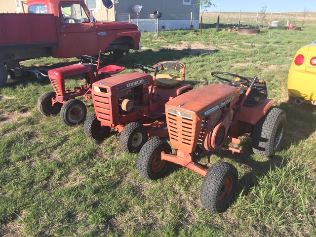

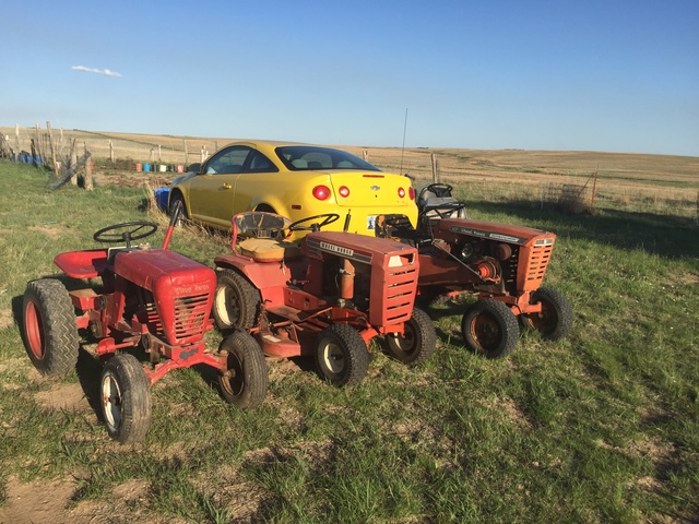

ClassicTractorProfessor 5,455 #1 Posted April 26, 2016 Got home from work tonight and the wife and I decided we would go for a ride...so she hopped on her Commando and I hopped on the 1277 and away we went. We just pulled out onto the road and I challenged her to a friendly bet on a race (of which I pulled away from her pretty easily lol) when all of a sudden mine started cutting out and finally just died. Tried for a good fifteen minutes to get it started with no luck...acted like it was not getting any fuel so my first thought was fuel pump quit. Had Katy pull me back to the house and removed the fuel line...plenty of fuel...so put it back on and it finally started but ran rough. Guess I'll order a kit for it tomorrow and see if that helps. On the bright side I did get pictures of all three of them together and a better one of Katy with her Commando, which of course she had to rub it in to me about pulling me home 3 Share this post Link to post Share on other sites

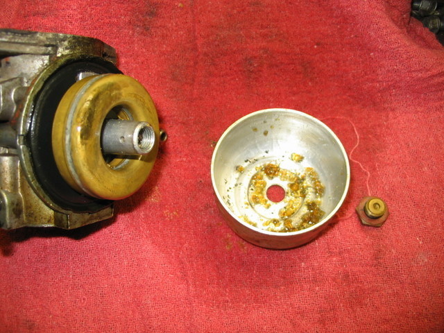

daveoman1966 3,884 #2 Posted April 26, 2016 I experienced the EXACT same symptoms with my Bronco 14 today...it has a 14hp Kohler engine. Here is what I found and you will probably find the same issue....its from the ethanol gas we use today. There are little bits of jelled gas in the carb bowl and in the jets too. You'll have to pull the carb and clean it thoroughly as I did. 2 Share this post Link to post Share on other sites
