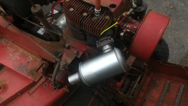

WHnoob 21 #8 Posted May 1, 2016 Great news! The K341 is now running like a champ! I reached the conclusion that the fuel starvation was caused by vapor lock and the otherwise rough running was mostly due to the ignition coil. Here's what I did today, with media: 1. Replaced the rebuilt metal fuel pump with plastic one from eBay. The fuel flow is much stronger, but it still started stalling after ~10 minutes of mowing. When I detached the pump output hose to check flow it was under pressure, and it was bubbling like the fuel was boiling in/around the pump. Original pump - wimpy flow: oldpump.mp4 New pump: strong flow: newpump.mp4 Boiling/bubbles: fuelboil.mp4 2. Replaced original Nelson muffler with "Gravely" style pointed out the right side of the tractor instead of crossing the front of the engine. This seemed to clear up the stalling issue. It's still loud as hell - sounds about the same as the Nelson even with its detached innards. 3. Replaced ignition coil and spark plug wire. New coil measured 3.3 Ohms primary, 9.8 kOhms secondary. Spark tester showed strong, consistent spark. I forgot to test the old coil beforehand, but I recall the tester not being as bright/consistent when I did a couple weeks ago. spark.mp4 I have a replacement carburetor also but did not install it yet - didn't want to change too many variables at once. However I did notice a lot of governor hunting at mid-throttle while sitting. So I put a few drops of oil around the throttle shaft and the hunting stopped completely. So the throttle shaft wear is definitely still an issue, but not as noticeable at full throttle. While it was sitting I also changed the transmission oil - yuck! So finally I got out and finished mowing the lawn, which was getting pretty long and still had over-wintered leaves in some spots. As proof, here are some short clips of me tearing through the high grass and leaves: mowing_1.mp4 mowing_2.mp4 revup.mp4 Share this post Link to post Share on other sites
