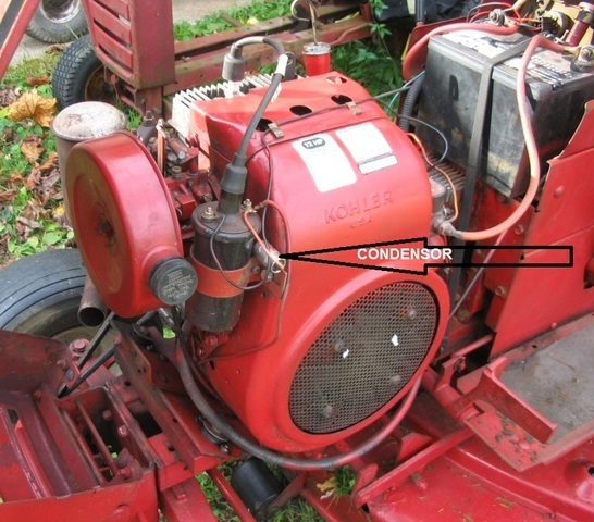

daveoman1966 3,884 #9 Posted April 30, 2016 (edited) The condenser (condenser) is a little thingy bolted to the engine shroud nest to the coil.....see in this pic. Over time, these go south.. cheap item is less than 5 bux. Edited April 30, 2016 by daveoman1966 Share this post Link to post Share on other sites

ahthurungnone 0 #11 Posted April 30, 2016 I was wondering what that little thinking was. Should I replace the coil while I'm at it? And thanks for the pic! Listings for the condenser also have points. Should I buy both? If so, where do I install the points? Share this post Link to post Share on other sites

daveoman1966 3,884 #13 Posted April 30, 2016 3 hours ago, oldredrider said: Not to hijack, but Dave, what is attached to the air cleaner housing? I'm not sure. The air cleaner cover has a short-nipple air pipe and I just covered it with a cap from a 2 gal antifreeze jug. Maybe that air nipple was for a snorkel....lol. I've never seen one like this either and I've long since sold that tractor. Share this post Link to post Share on other sites
