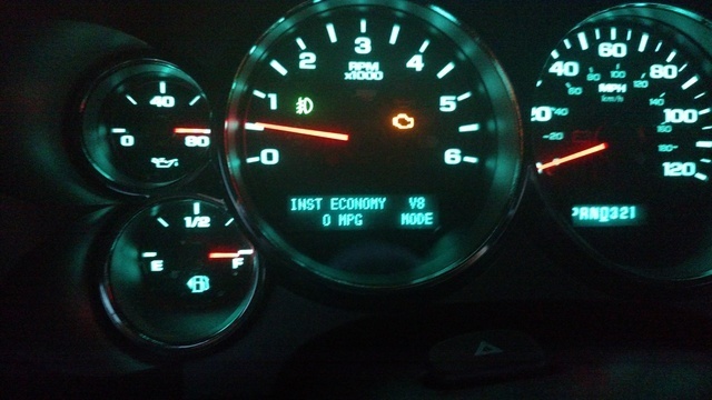

KC9KAS 4,746 #13 Posted April 15, 2016 I have a 2003 Z-71 (185,000+/- miles) and the oil pressure will be "0" then peg as high as it will go. It has an electronic dash and has been replaced once, and it probably has problems again. I did buy a new oil pressure sending unit, but haven't had it put in....It takes a "special" GM tool OR remove the intake, and I don't want to do/pay for that! Share this post Link to post Share on other sites

RedRanger 1,470 #25 Posted April 22, 2016 So now that you guys jinxed me with this thread, I'm driving home the other day and my oil gauge pegs and the engine light comes on. I picked up a new sending unit and yesterday morning before work I figured 10 minutes and I could swap out the unit...right? @#$%@#$ truck! After an hour of gymnastics and playing twister under the hood of my Sierra with sliced and gouged knuckles, I finally got the old sending unit out. Now to install the new one.... Got it lined up and threaded in like playing operation, don't drop it or you'll never see it again. As I snugged it down, it snapped off nearly flush with the engine block! #$%@#$%@# GM engineers! I've got about 1/4 inch of sending unit sticking out of the block. Even worse, can't get a tool in there to try and remove it because the morons at GM in their lack of mechanical experience put the damn thing behind and below the rear of the intake under the firewall and transmission tunnel while camouflaged under a nest of tubes and wires. I now have to remove the entire intake system from the engine to hopefully remove the threaded base of the sending unit. If the threaded base does not come out I'll be really screwed. I'm sure this will be a good 4-8 hour process this weekend. What a shitty design. Why are auto engineers morons? Share this post Link to post Share on other sites
