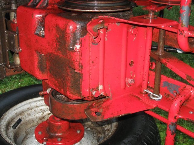

pfrederi 20,269 #5 Posted April 8, 2016 (edited) Does your 416 have the correct spindles for the 6"heels? They stick down below the axle further to make up for the smaller wheel. Edited April 8, 2016 by pfrederi Share this post Link to post Share on other sites

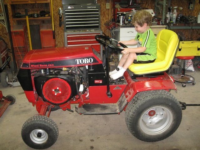

N3PUY 1,031 #13 Posted April 8, 2016 My 416-8 has 6" front wheels. 1 Share this post Link to post Share on other sites

cleat 8,938 #16 Posted April 9, 2016 2 hours ago, N3PUY said: My 416-8 has 6" front wheels. and a John Deere seat.... Share this post Link to post Share on other sites
Tankman 3,528 #17 Posted April 9, 2016 15 hours ago, N3PUY said: My 416-8 has 6" front wheels. What's with the "sunny" seat? Duplicolor Fabric & Vinyl Paint can fix that very well! Share this post Link to post Share on other sites
Phatboy 566 #18 Posted April 9, 2016 N3puy yellow seat !! Sacralige !!! Share this post Link to post Share on other sites

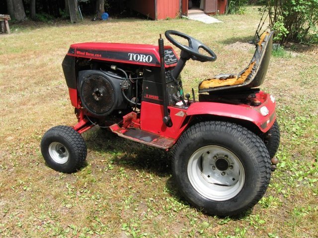

N3PUY 1,031 #21 Posted April 9, 2016 2 hours ago, Phatboy said: N3puy yellow seat !! Sacralige !!! I like to think of it as my "Surplus City" seat. It was only $13. Much better than the seat that came on my $40 tractor with the broken frame. 1 Share this post Link to post Share on other sites
cleat 8,938 #22 Posted April 9, 2016 Holy crap, broken frame or not that was a smoking deal. Share this post Link to post Share on other sites

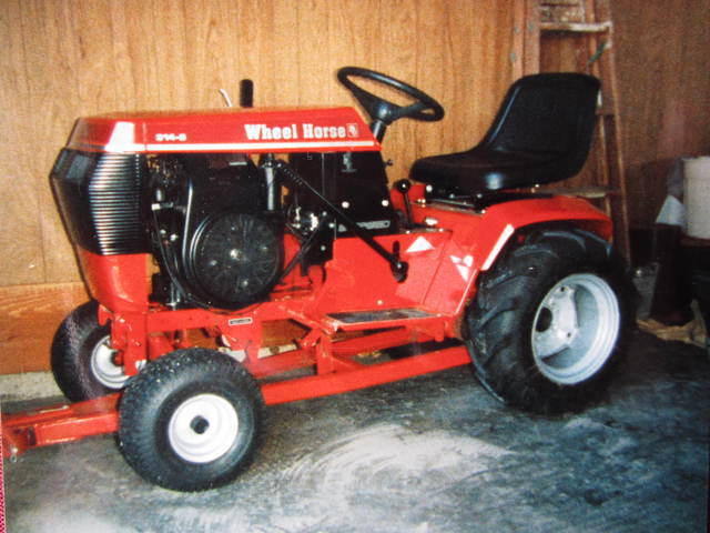

TDF5G 2,073 #23 Posted April 11, 2016 My Dad's 1985 314-8 purchased new with 6" wheels. He used a 42" deck. Share this post Link to post Share on other sites
