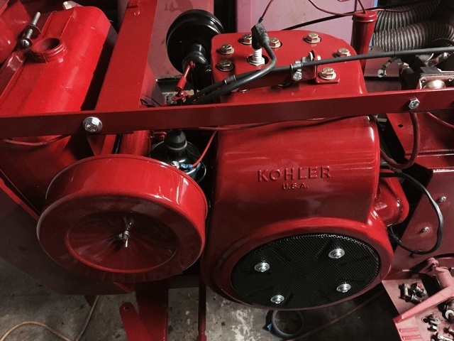

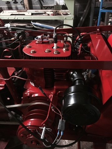

dells68 7,499 #1 Posted April 3, 2016 Well, it's official-I'm sick in the head! I've been working on the GT14 I bought from limited12. I had to put a head gasket on it and a rectifier. Well I couldn't leave well enough alone and decided to freshen up the engine and surrounding areas. I'll get to re painting the outter panels later on. I'm pretty pleased with the way it's looking - just hope she starts as good as she did before I started this project! Last pic is of her when I got her. 23 Share this post Link to post Share on other sites

dells68 7,499 #7 Posted April 3, 2016 Thanks guys. Emory came down last night and looked at it as I was putting the head back on and his comment was "That looks awesome!" Doesn't take much to make him happy, but that meant the world to me. Amazing what the love of a child does for your heart! I'll try to get another better pic when I can pull it outside later this week. I wish I had the whole thing looking like the motor, but I have to do things a little at a time. I'd like to have it finished in time for the big show 3 Share this post Link to post Share on other sites

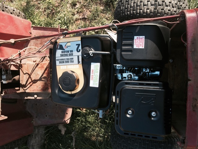

dells68 7,499 #16 Posted April 3, 2016 Aldon, the 13 was a conscious choice sine it has its own fuel tank. I had to pull the original tank for space. The 22 hp would have fit size wise, but would have needed an external gas tank. Couldn't decide where to put one, plus I couldn't afford the 22 on my budget. Yup the other tractor in the pic is getting the predator. I'll post some pics when I get it mounted and let you know how it works. Certainly is a hood full 1 Share this post Link to post Share on other sites
Aldon 4,832 #17 Posted April 3, 2016 Good to know. i have thought of a Predator repower. based on what your observations are, if I want to go with a 22Hp, I will need to extend the frame rails.... Share this post Link to post Share on other sites
dells68 7,499 #18 Posted April 3, 2016 but you'd need to find somewhere to mount the fuel tank. I'd thought about making or having one made that would look like a weight set on the front if I had gone the 22 route. I'll try to get some pics and post them tomorrow if I get home in time tonight. Share this post Link to post Share on other sites

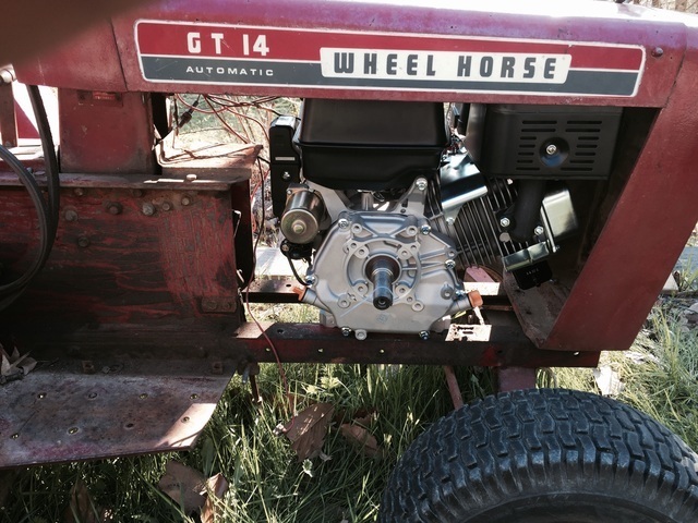

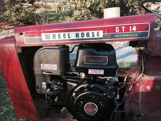

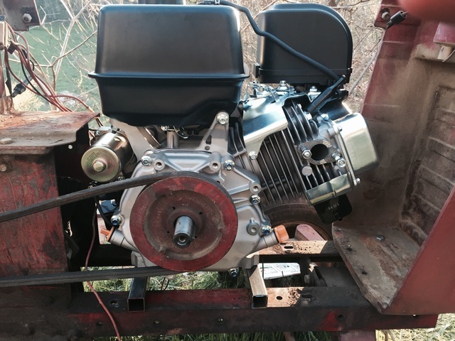

dells68 7,499 #19 Posted April 4, 2016 Well, I played mounting the 13. If the pulley would have lined up, it would fit nicely between the hood braces. Buttt...I'm going to have to raise it 1" and scoot it to the left about 1 1/2". Now, do I want to modify the brace and trim the hood, or do I want to raise the grille and dash about 2"? Also, I've got an adapter sleeve for the crank - just haven't put it in yet. 2 Share this post Link to post Share on other sites
Aldon 4,832 #20 Posted April 5, 2016 That 13hp does fill up the space doesn't it. Looks challenging for sure. So so if I understand correctly, to center it makes the drive pulley sit too far to right side. True? If so, no help for it but to move engine to left. Unless pulley could be installed closer to engine. Is ther space if you use larger ID pulley? As for raising it an inch, why? I am not able to work that out from the pics. Would it clear hood if you slide it to left if you did not raise it? I I imagine that you could disconnect the fuel tank and install it remote with fuel line. Not sure if you can similarly mount air cleaner differently. Share this post Link to post Share on other sites
953 nut 67,364 #21 Posted April 5, 2016 I seem to remember a re-power post not too long ago where the hood side had to be modified like this, think they used a piece of 3" EMT electric conduit to make the bump-out. Not sure, but that is my recollection. Share this post Link to post Share on other sites
dells68 7,499 #22 Posted April 5, 2016 Yup, it has to slide left to get the pulley to line up. I had to raise it an inch to get the belt to run correctly in the belt guard. K321 has a crank centerline about 6.5" above the frame and the predator is about 5.5". I wonder now that you mention it, if I could make a relocation bracket that would slide the tank right and still keep it engine mounted? But that leaves me with the air cleaner. When you pull off the plastic cover, there is a paper canister filter with a foam prefilter, so I'm hesitant to leave the cover off. I know the go cart guys use a different filter on the 6.5hp version. Wonder if there is a different filter for the 13? I'd prefer not to cut the hood unless I have to just in case I want to put a Kohler back. 3 Share this post Link to post Share on other sites
Aldon 4,832 #23 Posted April 5, 2016 You could make a fiberglass mold of the hood, then modify the mold. Then make a fiberglass hood thereby saving hood for possible reverse retrofit later. A lot of work though....but a cool project. If you need a spare horizontal support bar, I can bring you one to show or send one... Share this post Link to post Share on other sites

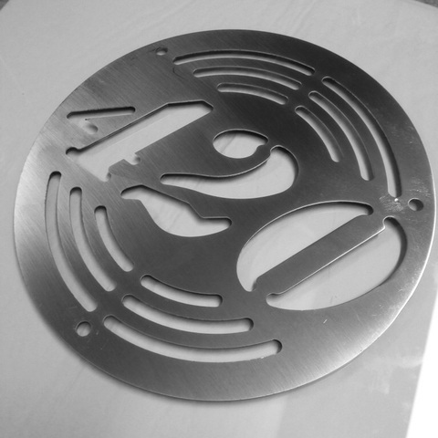

dells68 7,499 #24 Posted April 5, 2016 Thanks Aldon! I'm not in a hurry with this project, as I have my good GT I'm working on too. I just finished the wiring on it and plan to try to fire it tomorrow evening if I can. At least I have power everywhere it is supposed to be - I think (checked with my multimeter). I was trolling a little while ago and see that there are several mod parts for this engine. I'm not crazy about the air cleaners though. You can even get a pull start delete plate. It would be cool to take this idea and have one made with a wheel horse logo (anybody feeling froggy?). I may try to move the gas tank inboard and modify the air cleaner somehow. Oh well, been a long time since 5:30 this morning, time for some shut eye! 2 Share this post Link to post Share on other sites

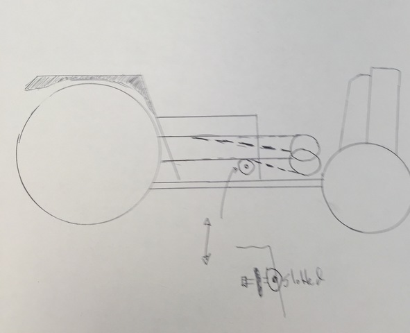

Aldon 4,832 #25 Posted April 5, 2016 I would have to sit across from my project tractor but I would probably try lowering the engine even if I have to cut weld the frame to save the hood and clean lines...if possible. I am thinking that it might be plausible to install a flat idler pulley nearer to engine on the upright frame piece to allow belt to navigate appropriately to avoid impacting belt guard and allow engine to be lower. If it negatively impacts hydro operation, it is less intrusive and easy to pull back off and go with more intrusive plan. i made a sketch. I know:-) I am no draftsman. Lol 1 Share this post Link to post Share on other sites
