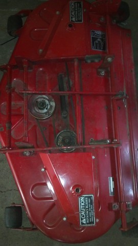

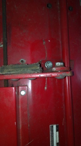

plumb-r 34 #1 Posted March 27, 2016 Ist post on the forum. I bought a 1980 C-145A tractor last fall. I just took off the snow blade and was going to get ready to mount the 42" rear discharge mower deck. I noticed that when I got it that the deck had two cracks in it, by each of the brackets that hold the deck to the tractor. The cracks are only an inch or two long. Question is do I just have them welded or should I also have a piece put on from the bottom side of the deck so there is a larger area to bear the weight and stress? 3 Share this post Link to post Share on other sites
slammer302 2,157 #2 Posted March 27, 2016 I would weld it and add sum large washers on the bottom or a plate on each side. that is a common place for cracking. Good luck that looks like a very nice deck 2 Share this post Link to post Share on other sites

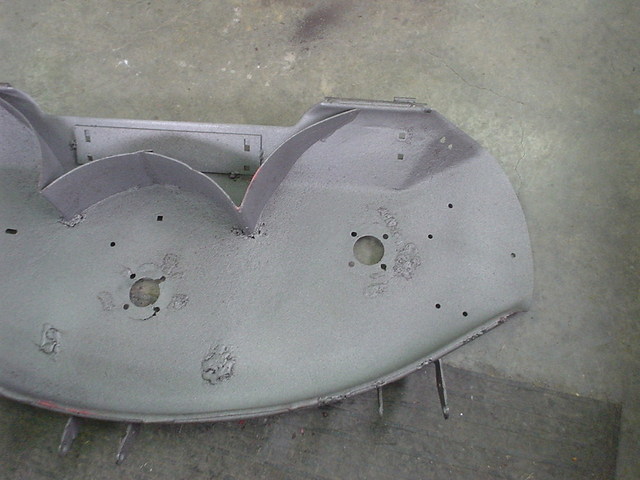

cleat 9,054 #10 Posted March 28, 2016 My side discharge decks have plates on the inside from the factory. They still crack some so no guarantee. This is one of my decks as I received it. Bad welds and lots of cracks. You can see the plate near the rear of the deck. Front mounts had no plates and cracked then were poorly welded up. This deck is currently at my welder's being repaired. 3 Share this post Link to post Share on other sites
