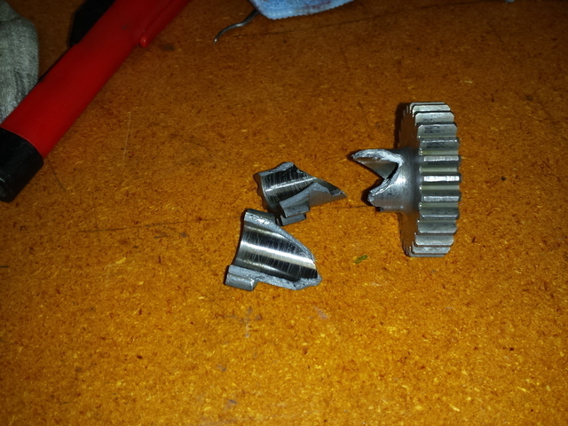

moe1965 774 #6 Posted March 20, 2016 (edited) Here is what happend. When i assembled it one bolt that bolts the The trans to the frame was to long. It is a through hole into the trans. The bolt hit the high low lever not letting me select between them. In the process of just finding that out I did braak a gear. I had a few choice words. The trans is totally dissembled. My issue now is are there replacement parts available? Here is a picture is the broken gear. modle number is 1 0301 7 from what i can figure out its a 1972 Edited March 21, 2016 by moe1965 more info Share this post Link to post Share on other sites

stevasaurus 23,763 #8 Posted March 21, 2016 Looks like part # 7206 gear reduction. Send a PM to "racinfool40" (Mike)...I'll bet he has what you need. @racinfool40 Share this post Link to post Share on other sites
