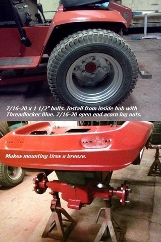

Tankman 3,528 #4 Posted March 9, 2016 1 hour ago, Aldon said: The style wheel weights that mount from the inside require longer bolt with 9/16-18 fine thread to mount to rear of hub, pass through allowing lug nuts to fasten the wheels onto hub. A search of McMaster Carr and initial web search did not pay off but I am on business travel and would like to get something ordered and on the way. Any ideas? Which Horse are you using? My Horses all use 7/16-20 lug nuts. Share this post Link to post Share on other sites

pacer 3,179 #6 Posted March 9, 2016 It didnt quite click when I read the 9/16 part that aldon obviously wasnt talking about the majority of our horses which use the 7/16 thread -- the big D's also use the 9/16 thread which I have 4 of those. I have a set of alignment 'studs' in both threads. I do have a 9/16x18 all thread and if memory serves I got it from McMaster. 1 Share this post Link to post Share on other sites
