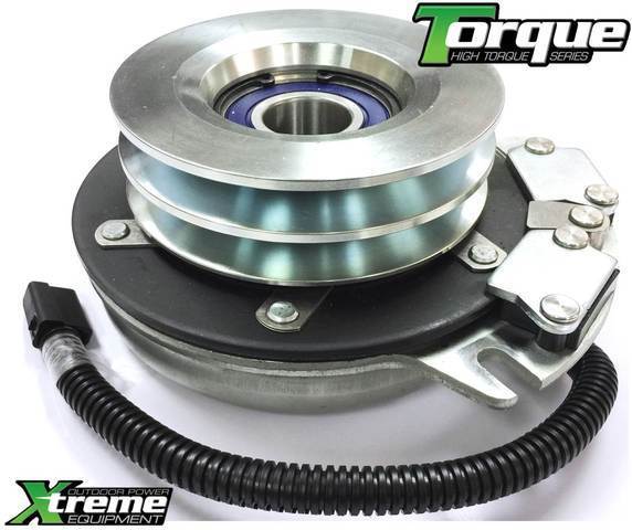

82Caddy 851 #15 Posted March 9, 2016 52 minutes ago, WNYPCRepair said: Here is a guy putting one in a D series. If you search the forum for predator, you will find others. He used an electric PTO on the D series. I think you're referring to me? 37 minutes ago, shallowwatersailor said: Another thing is the price of an electric PTO is not cheap for an engine like this. It's much more affordable then one would imagine. Hop on ebay (there's 4 right now) and single pulley electric PTO's for 1 1/8 shafts can be had for 60-75$, add in a 15$ sleeve adapter to get from the 1" predator PTO shaft to an 1 1/8" on most electric PTO's and your side load issue is no longer an issue. If you wanted a double pulley, things get more complicated but can still be overcome with a bit of research/imagination. Share this post Link to post Share on other sites
WNYPCRepair 1,924 #16 Posted March 9, 2016 7 minutes ago, Howie said: I did not go look at the parts list on these, just saw the bearing reference on the latest flyer. If indeed they are the plain bearing an electric clutch would be needed. As far as the Kohler K series none of the multiple engines I have rebuilt over the years have had anything but ball bearings on each end. I don't have experience with the Magnums though. Did have a late model V-twin in my shop last year, plain bearing had thrust bearing on pto side. Ah, OK, I was just going by what I have read here, I'm definitely no mechanic. 1 minute ago, 82Caddy said: I think you're referring to me? LOL, yes, and a nice job too. Share this post Link to post Share on other sites
Howie 900 #17 Posted March 9, 2016 I just looked at the parts list and as said above it just shows a thrust washer. Yet in the description they specifically say ball bearing shaft. Looked on another site and it says ball bearing supported horizontal shaft. Something amiss here! 1 Share this post Link to post Share on other sites
shallowwatersailor 3,221 #18 Posted March 9, 2016 Maybe Customer Service can answer the question. For technical questions, please call 1-888-866-5797. ITEM 61614 Could there be an improved version with ball bearings? Share this post Link to post Share on other sites
shallowwatersailor 3,221 #19 Posted March 9, 2016 (edited) 8 hours ago, 82Caddy said: It's much more affordable then one would imagine. Hop on ebay (there's 4 right now) and single pulley electric PTO's for 1 1/8 shafts can be had for 60-75$, add in a 15$ sleeve adapter to get from the 1" predator PTO shaft to an 1 1/8" on most electric PTO's and your side load issue is no longer an issue. If you wanted a double pulley, things get more complicated but can still be overcome with a bit of research/imagination. Here is one but it still is another $130-$180, plus the sleeve. It actually has dual pulleys and replaceable ball bearings, although if used with a snowthrower the pulley for the #79362 version would have to be substituted. At that price point, I would rather do another 10 HP diesel conversion that can accept the Wheel Horse PTO given the thirst that twins have. Edited March 9, 2016 by shallowwatersailor Share this post Link to post Share on other sites
82Caddy 851 #20 Posted March 9, 2016 13 minutes ago, shallowwatersailor said: Here is one but it still is another $130-$180, plus the sleeve. It actually has dual pulleys and replaceable ball bearings, although if used with a snowthrower the pulley for the #79362 version would have to be substituted. At that price point, I would rather do another 10 HP diesel conversion that can accept the Wheel Horse PTO given the thirst that twins have. I'm not here to argue. Just pointing out if you start looking at field coils, notice that if you find the right one (hint it's from a JD) it'll slide right over a wheel horse dual pulley electric pto and bolt up to the predator block. Different strokes for different folks I guess at the end of the day. Share this post Link to post Share on other sites
shallowwatersailor 3,221 #21 Posted March 9, 2016 10 hours ago, 82Caddy said: I'm not here to argue. Just pointing out if you start looking at field coils, notice that if you find the right one (hint it's from a JD) it'll slide right over a wheel horse dual pulley electric pto and bolt up to the predator block. Different strokes for different folks I guess at the end of the day. I'm not here for that either. This is the best Wheel Horse forum around, and is informative and helpful. I enjoy different schools of thought on the various topics. That is how problems are solved. Good to know that there is a way to make it work and that would be a good fit. I originally just Googled electric PTO and found some upwards of $300.00. That's where I thought the expense would be. I'm sure that I am not the only one that is disappointed that the Predator appears to not have ball bearings supporting the shaft, unlike their singles. 1 Share this post Link to post Share on other sites
