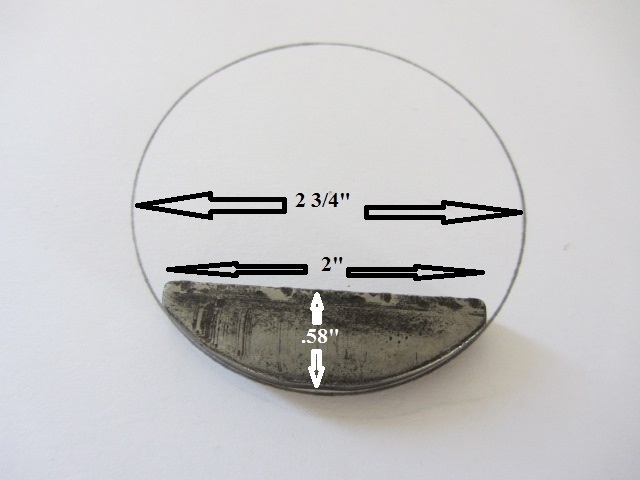

Hank01,
If you would care to check to see what the dealer might have, I'd be happy to compensate you for whatever the parts and shipping costs total.
They would have to duplicate the dimensions listed in the pic below to be the correct woodruff keys for my GT 14 axles......and of course, .25" (1/4") thick.

Visually, because no key sizes are given, ONLY the D-200 woodruff keys (still shown in place in the axles) match the GT 14 woodruff keys.
All of the rest of the woodruff key appear to be smaller......I lay money on the table that they are smaller.

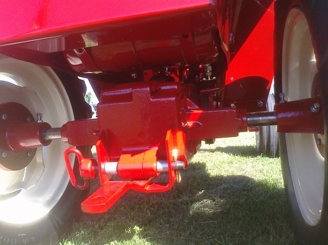

From what I remember when rebuilding my 1054, The 953/1054 axles use the 2" long key as well. The 953/1054 and GT14 hubs look the same to me. They are also significantly longer (cover more length of the axle) than any of the standard size 5 bolt hubs.

    I am not well versed on WHs pre C series so forgive the dumb question.What's the tire sizes on the 2 models listed.Do they have 15" rims.
JimAnderson
Gloucester,Va
Martin
The 953 and 1054 used 15" wheels. 6.40-15 tires- you can just see the size in the left tire in pic above.

1/4" x 2-3/4" Key No: RX Woodruff Key
Fastenal Part No. (SKU): 69352
Grade:1035
Key Number:RX
Length:2-3/4"
Material:Steel
Style:Half Moon
Type:Woodruff Key
Width:1/4"
Product Weight:0.064 lbs.
https://www.fastenal.com/products/raw-materials/keyed-shafts-keys/woodruff-keys?term=woodruff+key&r=~|categoryl1:%22600930%20Raw%20Materials%22|~%20~|categoryl2:%22612385%20Keyed%20Shafts%209and%20Keys%22|~%20~|categoryl3:%22601145%20Woodruff%20Keys%22|~%20~|sattr03:^1/4%22$|~%20~|attrlength:1610|~
IMG_0553a.jpg.a4de15a3cc6f71694f24d183a1  IMG_0554a.jpg.881132902b420b48d044bbcefb
Left: OEM installed woodruff key, left axle   Right: Fastenal supplied duplicate woodruff key, # 69352

      I have a hydraulic fluid leak problem which originally WAS NOT particularly noticeable or troublesome.
      Now is would be better described as a HEMORRHAGE.
      Some of you may remember me doing battle a year ago last winter with the rear hubs on my GT 14 to originally correct an issue with one which had slid inward on the left axle.
      In the course of that adventure, it was mentioned to me that might be an excellent time to replace my 47 year old axle seals.
      They were leaking somewhat, but were not what I would describe as an emergency or huge fluid loss problem.
      I decided since it was the middle of winter and I was messing with the hubs, the suggestion made perfect sense to do some preventative maintenance at a leisurely pace given the time of year.
      So I was able to complete my horrific hub removal/woodruff key battle, but managed do the axle seal installation without major drama.
      I had completely drained the tranny prior to axle seal removal and upon installing the new seals and a new tranny filter, filled with fresh Type A tranny fluid.
      During the middle of the mowing season last summer, I began to note my hydro ground speed response was a bit sluggish and slow.
      After checking the fluid level in the tranny, I noted it was low.
      The system is a 4 quart system and it required over a quart to bring the fluid up to proper level.
      I checked around a different locations of the hydraulic system for some obvious telltale signs of loss.
      The new axle seals looked great, no loss there. The hydraulic cylinder looked OK from what I could tell after hosing the area down and running it again after cleaning. Didn't appear to be any significant or apparently loss there.
      The hoses looked OK with no cracking or splitting, and their fittings seemed to be leak proof.
      However after running the tractor for a while in a stationary position and using the control valve which lifts and lowers the mower deck, I could detect leakage out of the top of the valve. The leakage was only coming from the top of the control valve in the area immediately below the valve lever itself.
      My assumption is since I replaced the axle seals and stopped any fluid leakage in those two locations, potential leakage problems in the hydro system have migrated to the next weakest point.........in this case the control valve (#8363).
      Unfortunately, I did not attend to this problem last winter as I should have (DUH!), being aware of the problem.......which of course continued the remainder of the last mowing season.
      So..........guess what? The problem for some reason has not resolved itself without my engagement over the winter. And now its mowing season.......and in the two mowing sessions I've done since getting my mule drive problem and deck gauge wheel axle support problems resolved after running over a 3/4" steel form stake, the leaking/hemorrhaging control valve seal is only getting worse. I once again added over a quart of Type A fluid before my first mowing this year to bring the fluid to proper operating level.
      I know it needs fixed meaning new internal seals need to be installed. The problem is how to get to the control valve to remove it or manipulate it in some fashion to install the seals on the spool valve and get it reinstalled in the control valve body without tearing the tractor half way apart.
      Lots of older WH tractors have the hydraulic control valve on the outside of the hood stand or some side area of the tractor generally on the left just forward of the the seating position and under the dash area, which would make servicing the spool valve a relatively simple procedure.
      Not so with the GT 14.
      The control valve is located between two tall, heavy gauge "C" shaped steel panels which sit on top of the frame rails.The hood stand mounts to these "C" channel members. There is about 5 1/4" of width between the C channels......not a lot of room for a guy with big hands and fingers to operate.
      My primary question is can the control valve and its primary operating part, the spool valve which has two seals, be serviced without completely removing the valve body from the tractor???
      Is it possible to manipulate the valve after removing the mounting bolts from the right side C channel in such a way to gain access (the spool is removed from the bottom side of the valve body by removing a snap ring), either from the top or the bottom of the tractor to successfully remove the spool valve from the valve body, replace the seals, and reinstall the spool valve in the body of the valve without removing all the hoses and completely removing the valve from the tractor?
      Without the tractor running, will there still be residual hydraulic pressure in the lines and in the system in general which would cause fluid to spurt out once a component is removed.........a hose or the spool valve itself for instance?
      The control valve is WH part # 8363 and I see that Lowell Scholljegerdes (wheelhorseman1000) has a seal kit for resolving this leakage problem with "Control valve seals #7788". The seals are very reasonably priced and readily available and will undoubtedly fix the tremendous leakage at the top of my control valve.
      https://www.wheelhorseman1000.com/product-p/00123.htm
      The problem is what all is involved to get to the valve for the repair and how long something like this might actually take to get the tractor back in service?
      One of my big concerns is the hoses which are now 48 years old. They show no signs of leakage now, but I fear if I start manipulating and moving them around too much messing around with the control valve, I'll create a whole new dilemma.
      The big problem is its right in the critical time of year for mowing season here in Indiana, and with the mass quantities of rain we have had the last week or so, once it turns 75 or 80 or more, I'm going to need to mow twice a week just to keep up. Since my GT 14 is my only tractor and my prime tool for mowing, I just can't afford to have it down for a prolonged period this time of year.
      If there's not a decently quick and reasonably simple removal procedure someone can suggest, I may just have to continue to keep the fluid level up in the tranny and control the mess of the leakage around the top of the valve as best I can until a drier time of year when mowing isn't a pressing twice a week issue. I might even have to just grin and bear it and keep adding fluid until mowing season is over in the fall. That assumes of course the hemorrhaging doesn't get disastrously worse than it already is.
      I'm anticipating once this particular leakage issue gets resolved, the next weakest spot in the hydro system will show up, but first things first.
      Any suggestions or words of wisdom anyone has to offer about this repair, I am completely open to listening.
      Thanks,
      Steve
      p.s.  I've attached a few pics below of the control valve and the affected area which is leaking for your reference.
      leakage area circled
