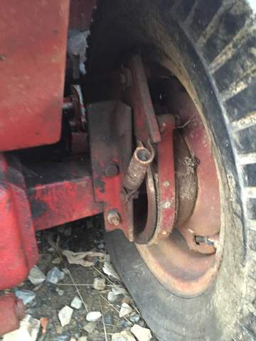

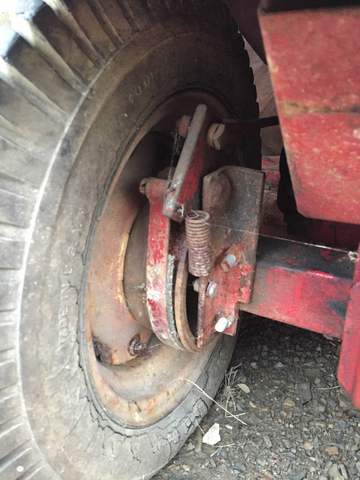

Tankman 3,528 #9 Posted February 8, 2016 Panzer never made a hydro. Share this post Link to post Share on other sites

RedRanger 1,470 #12 Posted February 12, 2016 Looks completely home made to me. Custom bands around drums from something? Share this post Link to post Share on other sites
Horse46 519 #13 Posted February 12, 2016 Why would it need two brakes, thats some braking given they don't go so fast? Down hill mowing?? Looks a decent enough conversion though. Share this post Link to post Share on other sites
kasey54 305 #14 Posted February 12, 2016 I've speculated it would aid you in steering while plowing or while rototilling . Who knows, kind of neat though 2 Share this post Link to post Share on other sites
953 nut 70,354 #15 Posted February 12, 2016 3 hours ago, Horse46 said: Why would it need two brakes, I personally love the shade-tree engineering on that braking system! I wish had put brakes on the wheels rather than the transmission. i live on a mountain side and have had the brakes become rather useless because of the design. Since the brakes are on the transmission and the stopping power goes through the differential, the tire with the least traction will stop rotating and the tire with traction will freewheel. My neighbor was grading his driveway with his 310-8, bumped the shift lever with his knee and it slipped out of gear. He applied the brakes and one wheel was skidding and bouncing as he went faster and faster; when he got to the switch-back on the driveway he and the went over the edge. God was watching over him because his mid-mount grader blade snagged on some mountain laurel about teen feet down the bank stopping him. I like two brakes! 10 Share this post Link to post Share on other sites

DennisThornton 4,773 #17 Posted February 12, 2016 First of all that is just awesome! Second, could you please check to see if he implemented them to have steering brakes? I sure miss them on my WHs! And finally, well for now, anybody recognize the brake assys? Maybe he didn't implement steering but maybe he like Richard, saw someone "slip off the mountain"! Share this post Link to post Share on other sites
pfrederi 21,312 #18 Posted February 12, 2016 Brakes smakes...who needs 'em Wheel Horses were designed to pull...not stop. 6 Share this post Link to post Share on other sites
953 nut 70,354 #19 Posted February 12, 2016 4 hours ago, DennisThornton said: anybody recognize the brake assys? Don't know for sure but it looks like a couple of old brake drums from a compact Mopar or Ford with home brewed brake bands. Some of them used rather small brake drums though these may be smaller, perhaps Cushman three wheeler? 1 Share this post Link to post Share on other sites
