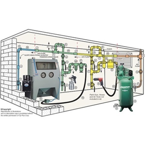

squonk 47,955 #18 Posted January 24, 2016 (edited) Get the TPCatalog. All kinds of compressor and plumbing tips. Put a riser on your air line drop and that will help with the moisture. It's all in the book. If you redo air lines, DO NOT USE PLASTIC!! The metal lines will help cool the air and reduce moisture. Edited January 24, 2016 by squonk 4 Share this post Link to post Share on other sites
Mr. 856 170 #19 Posted January 24, 2016 Great diagram. Someday I will follow suit. I need a new shop first. 1 Share this post Link to post Share on other sites
WHX?? 57,865 #20 Posted January 25, 2016 Agreed on the plastic Squonk... I have a pipe threaded at work and plenty of pipe/fittings so no problem there. Share this post Link to post Share on other sites
