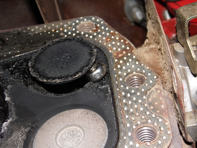

Molon_Labe 731 #15 Posted January 21, 2016 To give you a glimmer of hope, I had the same symptoms with my c-161 last winter and found this when I pulled the head... 3 Share this post Link to post Share on other sites

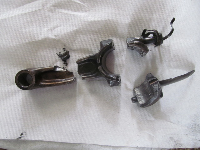

Ed Kennell 47,818 #18 Posted January 21, 2016 Broken rod. Hope the crank is OK. Here's what I found in the free spinning 875 I bought. All it took was the new rod. Crank and piston were OK. Good luck. Share this post Link to post Share on other sites
